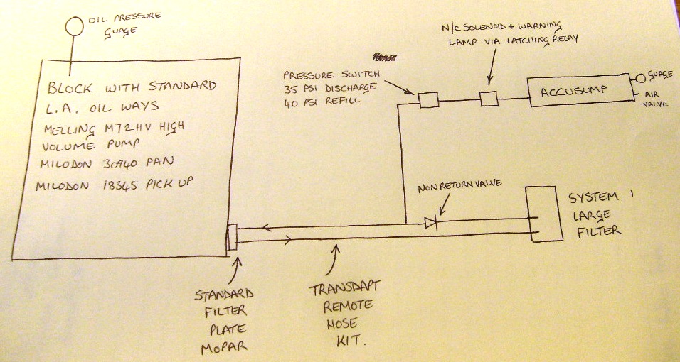

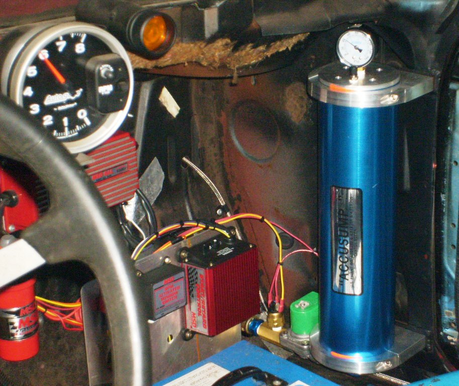

This is what I`m fitting, I have all the bits but is alot heavier than I thought.
This set up provides automatic pre oiling and surge control and gives me approx 30 secs worth of spare oil capacity should the worst happen. ( Hopefully enough time to save my motor )
Jon Connolly
Posts: 3116
Post by Jon Connolly »
I would recommend these to anyone
It is very reassuring looking over and seeing you have a reserve of oil ready.
The pre lubing is great too, takes 5 seconds only, then the motor is ready to go
The other thing is it is a nice bit of ballast that you can mount anywhere in the car
22nd sept2 005.jpg (197.64 KiB) Viewed 966 times
