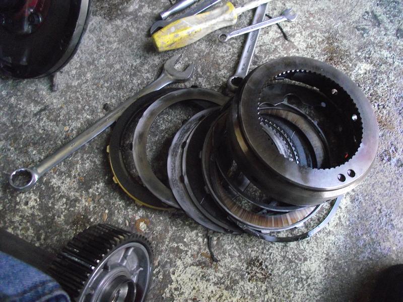

One step forward two steps back. after putting a few miles on the engine, which is running well apart from a slight clatter from the rockers, i think i will have to fit a new set, they are hardly loading the hydraulic tappets when on the back of the cam. the two steps back. the gearbox was lazy changing into top, and on start up sometime took forever to select gears. the short of it the box came out and both clutch packs are burnt.
Anonymous
n
Post by Anonymous »

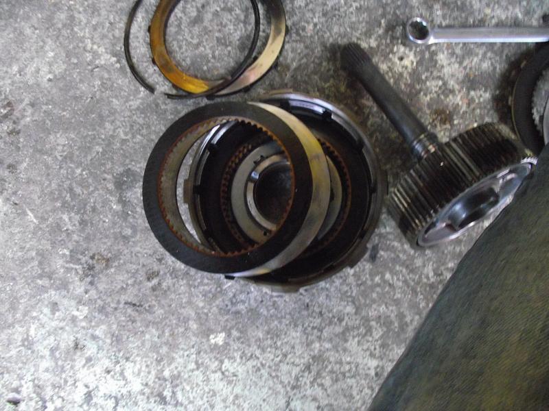

both clutch packs are well burnt
Anonymous
n
Post by Anonymous »

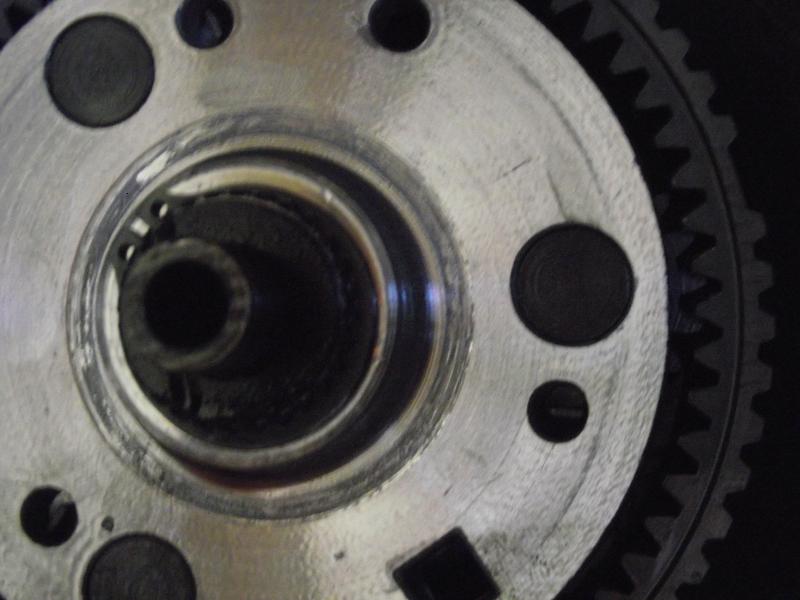

the front clutch assembly has been moving its lightly scored the epy gears casing.endfloat on the input shaft was a little excessive before i stripped the box, hopefully a new set of fibre thrust will sort this. i ordered a rebuild kit including both bands and a set of thrust washers inc shipping from the states. it was still cheaper than real steel.for just the rebuild kit without postage.

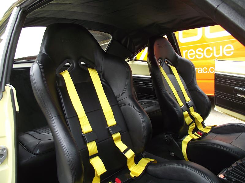

seat belts were fitted before the gearbox came out

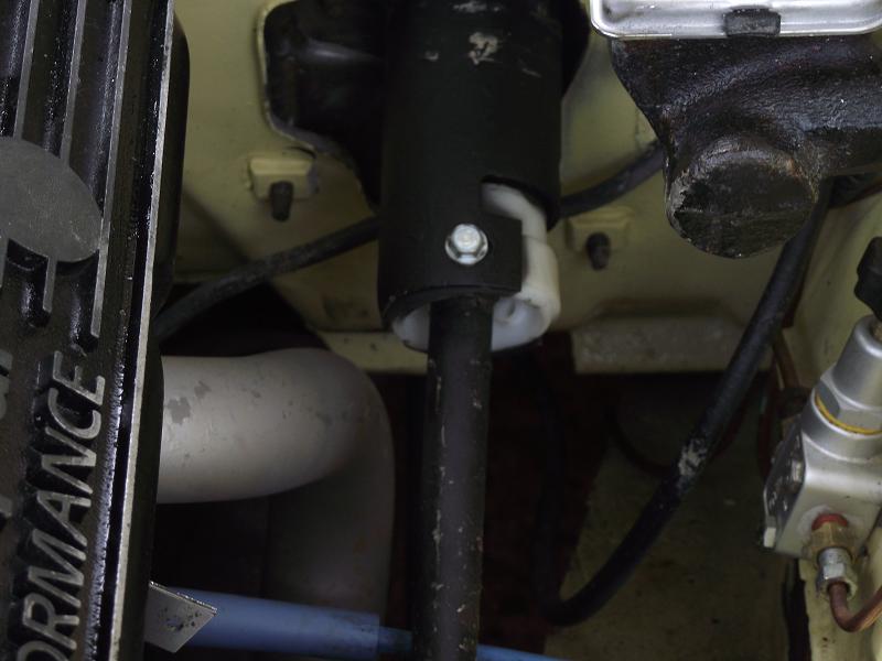

lower column bush turned up from the states, with a fuel tank filler neck rubber o ring. both were fitted.
