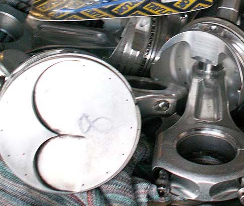

I have now got the quote for my new pistons.
The original pistons were gas ported and wondered about the merits of this feature.
so the question is "to gas port or not" that is the question
Koffle pistons.jpg (60.94 KiB) Viewed 1099 times

This is an interesting site and I think I may have answered my own question.
http://www.rehermorrison.com/blog/?p=29
go to link click on tech talk and go back to tech talk 22 interesting stuff.
Posts: 6747
http://www.rehermorrison.com/blog/?p=290
To save all that clicking . . .
Yes, I would gas port, as done previously ;) I guess your still using custom pistons, so gas port cost is not really an issue & in consequential really
