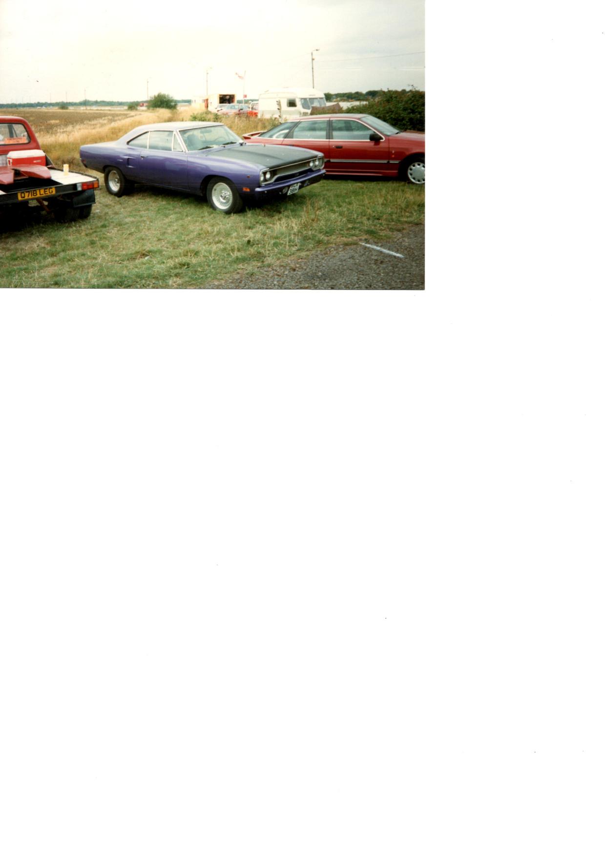

Jerry Smith wrote:Ok I'll have a go les, my old 63 belvedere, weighed 3500ld without me so 3700 all in race weight, 500ci mopar mega block, ported Indy 440-1 heads 718/690 roller cam and 14.5-1 compression, was mini tubbed and on ladder bars running a 28x12 slick, best 60ft was 1.41 best et was 9.80@136.6 oh and it was registered and used occasionally on the street, had an msd timing retard in the car so could instantly knock 5-6 degrees out put in optimax and it'd cruise nicely,
One of the sweetest mopar motors i've ever heard.
I believe this was yours as well Jerry.
Jerry Smith
Posts: 396
Post by Jerry Smith »
yes mick thats my old car, didnt realise at the time just how solid that car was when we restored it, one of the ones i should never have sold, although it doesnt apear to have it in that picture it was an airgrabber car
