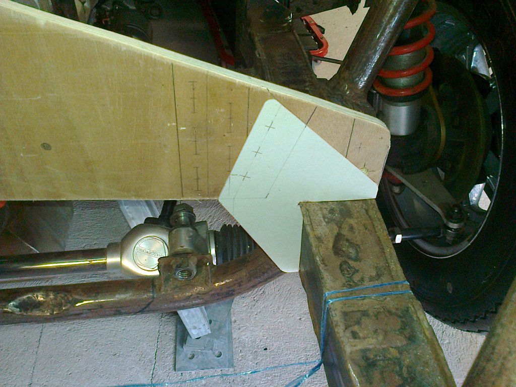

Meanwhile, here's the latest progress...

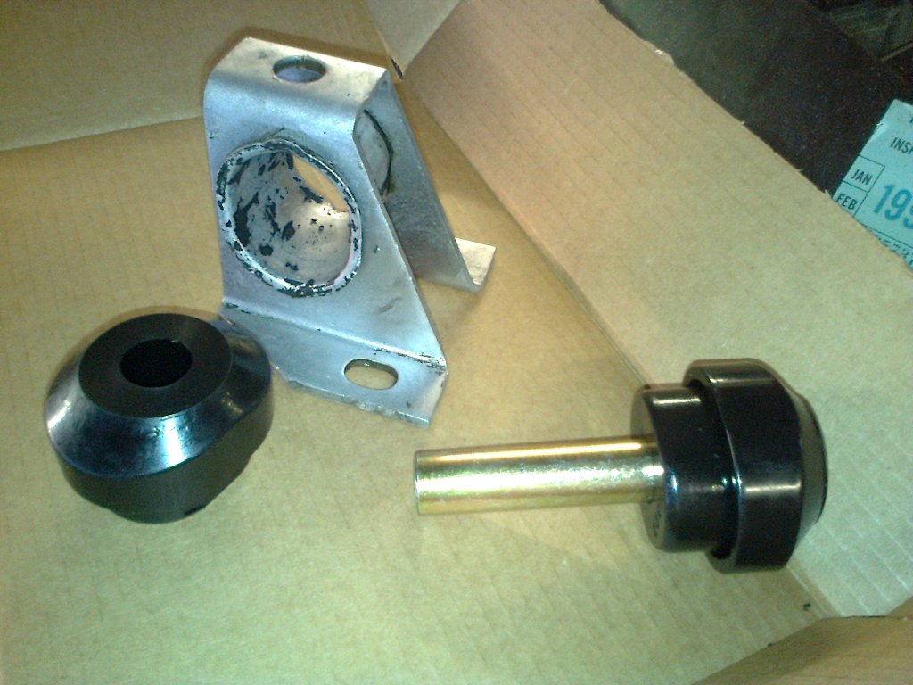

Trans mount with rubber hacked out, degreased & de-rusted. Poly inserts arrived from Summit
Anton's mount design put into Kellog's finest.
Trans mount and poly insert 01.jpg (127.35 KiB) Viewed 1806 times
Motor mount plan B 01.jpg (165.87 KiB) Viewed 1806 times

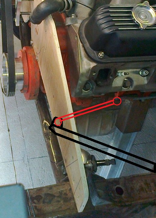

Pete wrote:It's Fore and Aft movement that you need to control.
Take it off the engine mounts and to the chassis - use both engine mount lugs - they have been known to break just one :shock:
I'm thinking of running them from the engine mounts to the steering rack crossmember (i'm going to run diagonal braces from the chassis rails to support this crossmember).
Whaddya think?
Motor torque straps.jpg (127.23 KiB) Viewed 1776 times
Posts: 14529
You definitely need to stop the engine moving fore and aft with a 4 speed. I had a motor plate on my Duster, you could see the engine moving when you depressed the clutch pedal, it turned out to be the reason the thing wouldn't shift cleanly at high RPM....

Get the headers in first and see what clearance you have.
Maybe you can put the bars from the mounts facing backwards, or as I suggested off the Trans "K" member, but I cannot remember if there are any easy place to pick up on the manual trans (I'ts easy with an Auto).....

all you need is 1 tie bar, either of the rear extension bolts on the trans mission rear wards to the crossmember, or a rod from a bellhousing fixing to front crossmember or off a block mounting nr the front to the front crossmember, a 440/383 have handy round holes facing down nr the pan rail front off the block dont know on a smallblock though..
