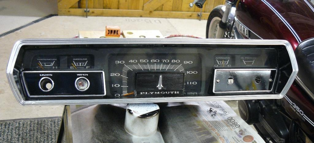

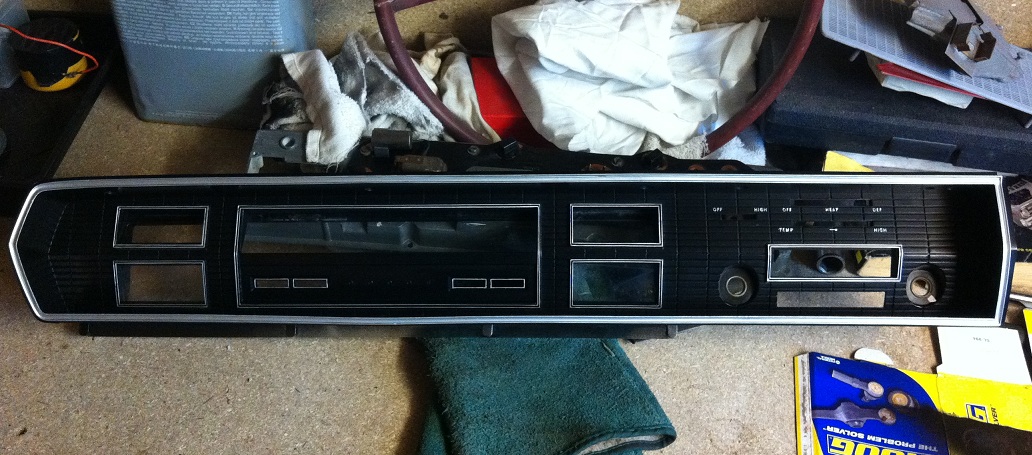

My dash looked a right state.
The black had been painted in tar with a blunt stick by a drunk who'd then gargled with some dull aluminium paint and dribbled it over the top :?
I used thinners and a scotchbrite to remove the mess and i've sprayed the lot gloss black.
Is there any way of re-doing the chrome bits?
Are the aerosol 'chrome' sprays as crap as all the reviews i've read?
2nd pic is what it should look like...

Posts: 8369
It's plastic. It originally had a chrome coating like you see on kids toys. Then it's overpainted with black. The wear had gone right through the black and the chrome.
It's to tricky to spray because of the lettering, etc :?

Posts: 8369
I tried out a can of Simoniz chrome paint and it's not actually too bad!
It ain't chrome but it's a lot better than just silver paint. I masked and sprayed the surround then sprayed some paint ino the lid and brush painted the detail bits. Beiing a clumsy oaf it ain't perfect but i'm happy with it :)
I've also replaced the heater controls with a 'delete' plate, drilled for a couple of switches.
Dash restored.jpg (86.46 KiB) Viewed 2420 times
