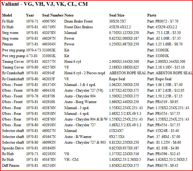

Was just checking out the old post Baz started with wheel bearing part numbers and did a bit of a search to make sure they are the same used on the VG.
Came across this list that may be useful to others at some point.
http://www.alliedbearings.com.au/datasheets/chrysler
Link may die in time so a basic pic of the part numbers/specs below.

well handy
