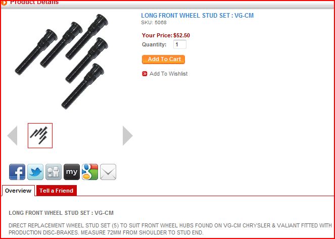

Loooonnng
72mm
And look to pass through the disk then the knurl seats in the hub.
Any thoughts on reusing studs that have been driven out?
http://www.pentastarparts.com.au/sunsho ... ail&p=5068
72mm

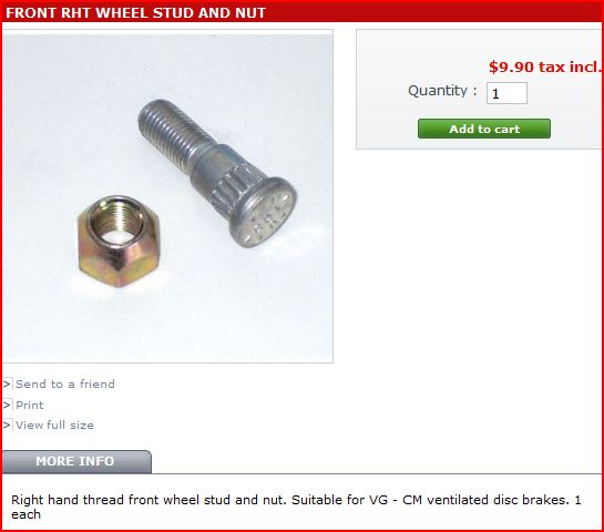

This looks a different stud again, appears to have the knurl to seat in the disc rather than the hub.
Maybe it does not matter where the knurl seats as long as the disk, hub and wheel are pulled tight when nuts are on and the knurl seats well to stop the stud spinning.
Any thoughts or experience?
Same application as the one above.
http://www.valiantspares.com.au/wheel-s ... d-nut.html
- Q_Val.JPG (38.17 KiB) Viewed 1486 times

Ah, that makes sense now. re the 72mm.Dave999 wrote:differing lengths for alloy ROH or GKN Sankey benson option W35 wheels...jelly bean mags. OR plain steels i think
I am left wondering about the spline (knurl - poor choice of word earlier) and shank length and diameter now.
You can see the first one has the spline placed to pass through the disk but seat in the hub (disk is mounted behind the hub). The shank seems to be larger diameter between the spline and head.
The second one has the spline closer to the head of the stud so it seats inside the disk. The rest of the shank would have to be correct diameter to seat inside the hub and stop movement.

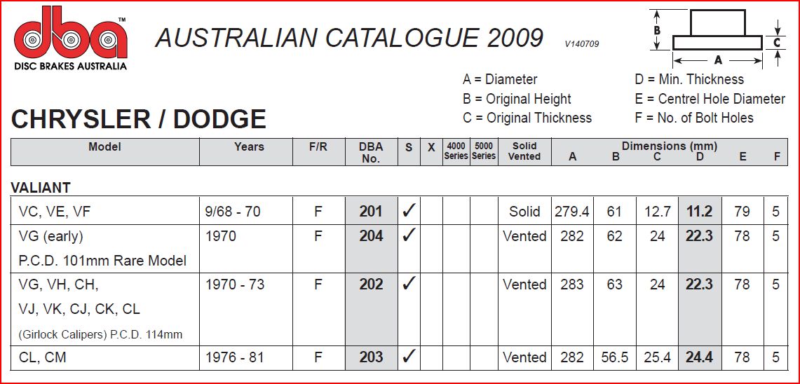

I suspect that the only difference between my new discs and yours will be where the holes are drilled. Reading below chart there may have been a small amount of extra machining. 1mm
Have an idea that if there is a set of hubs at a place a couple of hours to the north of here for a reasonable price I may get them to put in the shed.
Extract from the DBA catalogue attached.
Note the minor difference between DBA 202 & DBA 204

- My new rotors, made by RDA (Rotors and Drums Australia). Measured to be the same dimensions as the DBA specs above.
- Old rotors (both my VG and Terry's VH?) have a smaller diameter of roughly 275mm. Original factory fitted rotors I suspect. Maybe the later models VJ onward had larger rotors than the ones I have seen.
