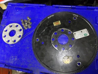

As Chevys have the starter ring gear on the flexplate not the converter you need adaptor and flex plate TCI, ATI do these.Kits use mid plate do adapt housing you wont need that with Ultrabell. Plates put mopar starter in stock location pretty sure Ultrabells do as well.
I have a TCI 8 bolt adaptor and flexplate(out of tag) if your interested.

If you get a chance, please could you post up some pictures of the adapter.

You can buy a JW glide case in Mopar bolt pattern.
As for the glide to mopar, I made my own mid plate, as original plate didn't meet my needs, I may have the old plate down the garage. I also have an older flex plate, again out of tag.
You also nned to space the starter out, kit came with a lump of ally, but had to chop mine about a bit. I also increased size of starter bolt, as found I couldn't get enough clamping force with their supplied size bolts. .. .

here you go Pete

Couple more piccys for you ;)
Tried to show a Starter packer
My old ring gear (130 Teeth)
