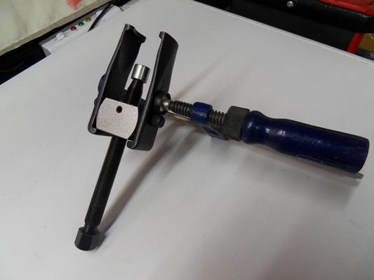

I used this set up to get mine off Justin....puller perfectly squarely on the pitman arm, G clamp tight on outside of puller then a socket on a breaker bar and it popped off relatively easily. My mate has it at the moment to do his Newport but you are welcome to it when hes done if you want it mate...
Cheers Steve :thumbright:

That looks like the beastie I need, yes, may well borrow that mate, just let me know when you haven't back or tell him I will pick it up :thumbright:
