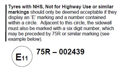

E markings are considered at the MOT test. If a tyre is marked with " Not for Highway use" it will pass at MOT if it has the following E mark. I think Matt is spot on though just because the tyre passes the MOTand you won't get a fine your safety has to be number 1 not to mention all your hard work and determination on the car going to waste. Listen to Duncans Pinto experience :thumbright: Swop onto these tyres when your at the Nats
not for highway.JPG (34.73 KiB) Viewed 1371 times

autofetish wrote:They are legal in the usa dot is the standard in the usa
Uk and Europa need to have a e in a circle the e mark
I did in my younger days sand off for racing only and make an e mark with hot punch set and hot round punch.
I also had demon tweaks cut smile faces in my tread. They will cut tread in slicks and it was cheap but was 8 years ago
Every time a copper pulled me over he was more interested about the flamer kit I had fitted with petrol and at one point a gas injection kit
I was running 13x10 slick on the road
but this was on the back of a mini with a 998cc engine ;)
I would put any wheels on the back then when you get there swap over
Sunny day on my own yeah
Yup, they are legal over here.... They are not in the UK.... By all means use them. Have an accident in them, you will not be insured! This whole thing came up a few years ago. They are DOT approved, but not for UK use.

You are right there Jeff. The insurance company would take one look at those after an accident and laugh all the way to the bank.
