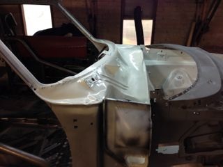

Here are a couple of photos of when I cut my scuttle panel out which you've done & mines a '69 B Body but this may help.

Cheers for those pics. I'm hoping to tackle this in the next couple of weeks and I think the hood, fenders and upper cowl are coming off.
Posts: 7670
Good luck Les....got to be worth taking loads of pics and posting exactly how you do it....bound to help someone in the future :thumbright:
