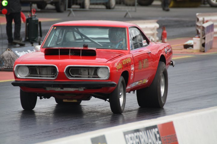

Clearing out my photos and i found some old photos from back when i ran SS springs ,,,,it launched sh..ite and wondered all over the track back then ,,,,,Superstock springs first,,Always ran about 8 to 9 llbs of air in the slicks...Notice the car is not digging in ,no rinkles in the tyres...

This one shows it launcing after i fitted Caltracs and beefed up frount spring hangers ...Also Andy Wright rebuilt the frount shock towers,,,Car ran on rails in the end,,,, I am bored if you wondered why i posted this :thumbright:

in fairness pete your already passed the staging lights in that first pic, but i dont doubt that it hooked up better with the caltracs

Fair play Chally ,,,i can,t argue with that ,,,,,,But you get the idea :thumbright:

I would put the bad handling down to the rear end being too high and the lack of support on the front shock towers.
My car has ran a 1.39 on SS springs.
