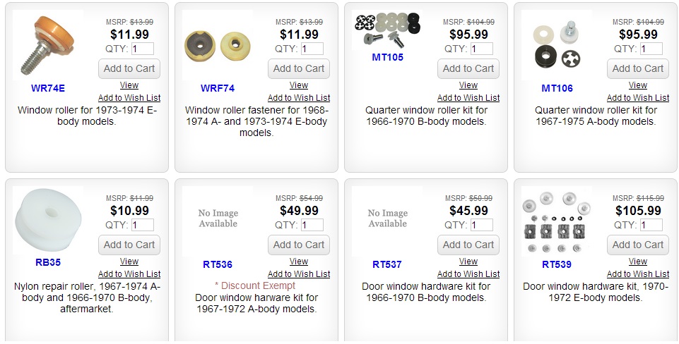

Found these (pic) so various bits are available. Lots of links on that article too.
Blue - Thats really kind. I'll make the offer. Thanks.
