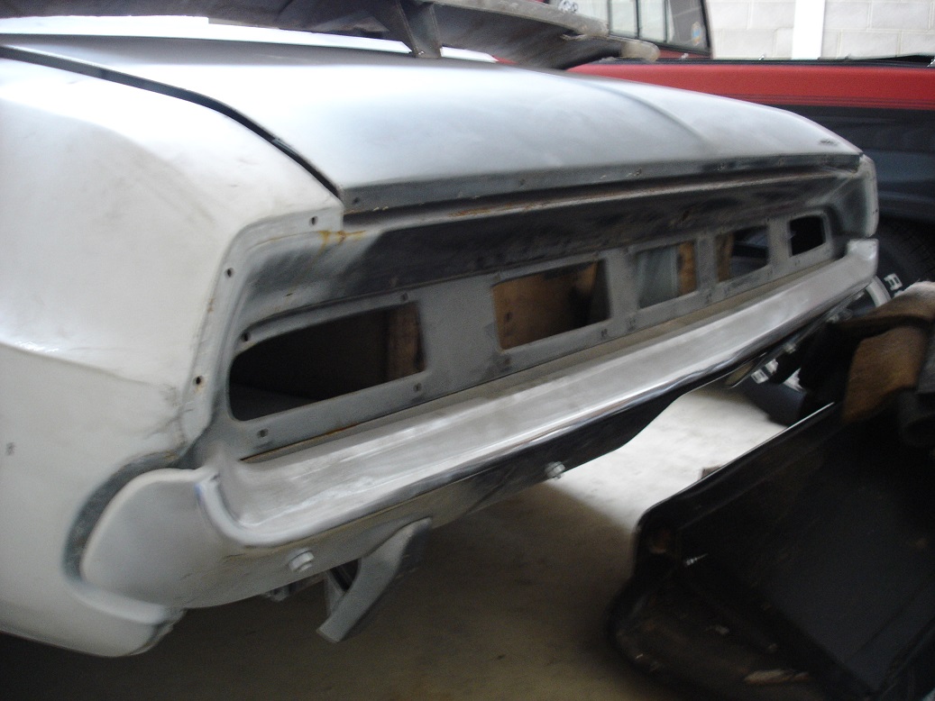

This is a picture of my 72 which has already had a 70 rear panel fitted. Might give you some idea of the differences/work involved in converting yours.
if you're going to convert, get a set of 70 lights first and then adapt the panel to fit them but I think the results would be better using the 70 panel. Good luck with whatever route you take.
