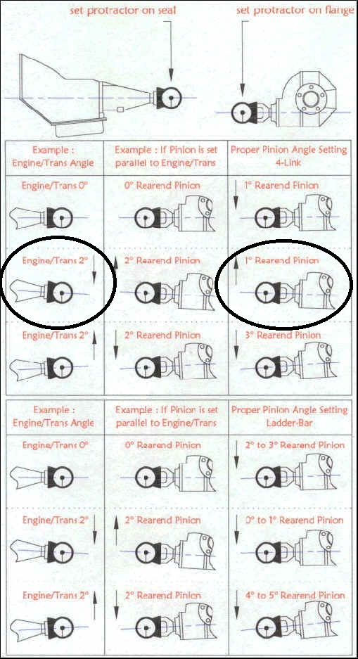

I found this helpful, especially as mine's non-standard (4-link)
I also found a digital magnetic spirit level was superb for jobs like this.
Ignore the circles- they're for my set-up!
Pinion angle chart.jpg (144.4 KiB) Viewed 3184 times

UJs work best at a slight angle.
Every rotation makes each UJ on the driveshaft rotate at the same speed.
The greater the angle in a UJ the further it has to swing in each rotation. So the faster it has to swing.
When they are at the same angle at each end of the driveshaft they are swinging at the same speed as each other. They are at the same frequency but out of phase by 180 degrees. So the frequencies they produce cancel each other out.
If one UJ is at a different angle to the other they have different frequencies.
When two different frequencies travel together you get some bits that are cancelled out as before but also other bits where the amplitude (height of the wave) is added together.
So now you have these spikes of vibration moving along the driveshaft with rpm.
Hope that is understandable.
