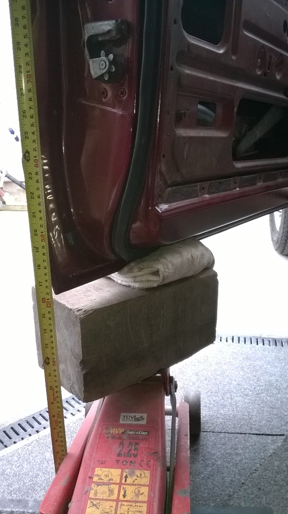

It'll be the same as mine.
Open the door far enough to get at the outer bottom hinge bolt.
Tape the edge so you don't damage the paint and loosen the bolt.
Take the trim panel off to access the two inner bolts.
Put a jack under the door and just take the weight. Loosen the 2 inner bolts slightly.
Jack the door up and retighten the 2 bolts, bearing in mind it'll drop a bit once you lower the jack.
Try it and repeat if necessary.
Next job is to get yet big screwdriver out and adjust the latch receiver.
That's just trial and error :thumbright:

Thanks db, i can give that a go, just need to my head around which the inner and outer bolts are? When you say trim panel, is that the kick panel next to the foot brake?
Posts: 8369
That's the one. One crosshead screw in the middle, you'll have to loosen the ally doorstep trim too, forgot about that!
When you open the door look in the gap between the door and front wing, you'll see one hard-to-get-at bolt.
It would be a lot easier with two pairs of hands but I didn't have that option, the jack worked fine though. Just jack it slowly and gently.
I measured as I lifted so I knew how much play there was.
Jacking door.jpg (240.16 KiB) Viewed 1041 times
