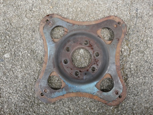

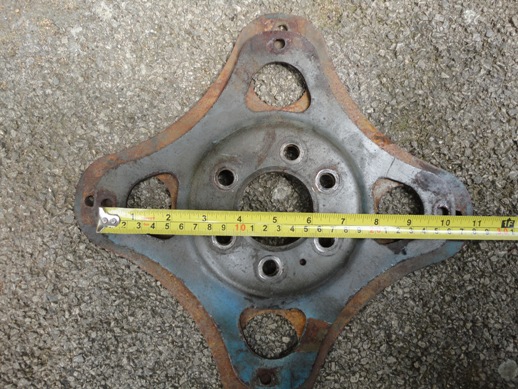

Box dropped this morning, flex plate out, and it is a different size to the replacement, so there are different size plates.
It seems I need a 10" flex plate, not an 11"
flex out1.JPG (112.51 KiB) Viewed 1731 times

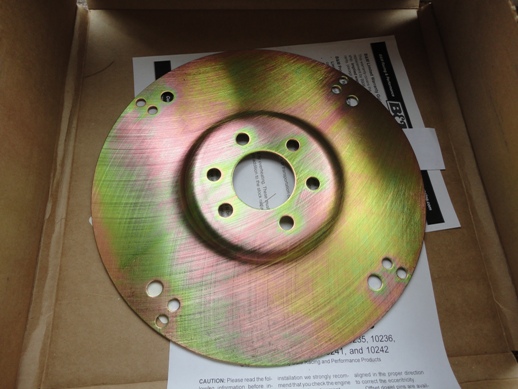

Got a new plate from Hausers now, a B&M one.
Pete, is this what you suggested was the best route?
new flex.JPG (97.57 KiB) Viewed 1690 times
Posts: 22204
Yep, told you I had a spare unless the crank bolt arrangement is different...not sure, really.....
Posts: 5944
This one lines up with all the holes, and there is a massive amount of metal compared to a factory one. Geoff Hauser said the standard ones break all the time.

Good choice Matt, I had one of those and they don't bend easy ;)

Turns out not a good choice. :x
All bolted in, everything hooked up, go to spin over for some oil pressure, starter won't engage.
get the Bxxxxxd off after dropping steering again, strip and check it, all OK, test on bench works fine, back on car same problem, just spinning, no engage.
check wiring (lots of time!!) with meter. All OK,
Last look underneath, and test shorting across motor terminals to make it spin.
Oh. Thats the problem then. Starter solenoid can't flick starter gear back into mesh with ring gear because the Bananarama! flexplate is too large a diameter.
Whole Bananarama! lot has to come out again to remove flex plate and replace it with a stock one.
