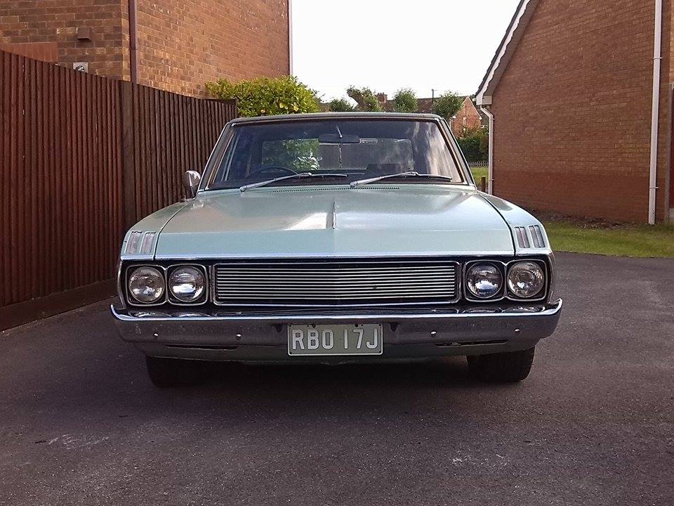

Hello there, I am the new(ish) owner of steves VG VIP from the club, ive recently tidied a few bits up on the old val and rebuilt the old back drum brakes. When doing this i found that i had a leaky master cylinder and was wondering if anyone had any advice on the best place to get a rebuild kit? Cheers!

Gday there mate. My names Richard and Im originally from NZ, living in the south west at the minute and bought the val off ebay start of the year. Had valiants in NZ previously and my brother currently owns a VH 318 wagon back home. Have tidied a few bits on the old girl and chucked some 15x8s on her. Just need to sort out the brake issue now!

Hi and welcome,...before you purchase a rebuild kit make sure that your master cylinder is serviceable,....as stated these are cast iron and can corrode in the bore (causing pitting) if that has happened a rebuild kit will not work. You have several options
1/ replace master cylinder with a different type ( do some research on bore and stroke dimensions)
2/try to find an engineering company that can machine it out to a size that will take an alternative seal( you will then need 2 seal kits ,.one fore the new bore diameter and one for the rest (original)
3/Purchase a reconditioned one from penta star spares in Australia , but dig deep for that option as they are on an exchange basis, so you pay the purchase price + exchange surcharge + postage ( remember it is heavy cast iron) + customs duty
Good luck
Ps if need a rebuild kit I have one , can post to you (£30)

Cheers guys thanks for the advice, I think the original master cylinder should be ok with a rebuild kit so if you have a rebuild kit for the VG Aussie pete that would be awesome. If you want to PM me we can swap details and il transfer the money to you? I did see the reconditioned units on a few sites but they are fairly pricey especially when chucking postage on top! Thanks guys
