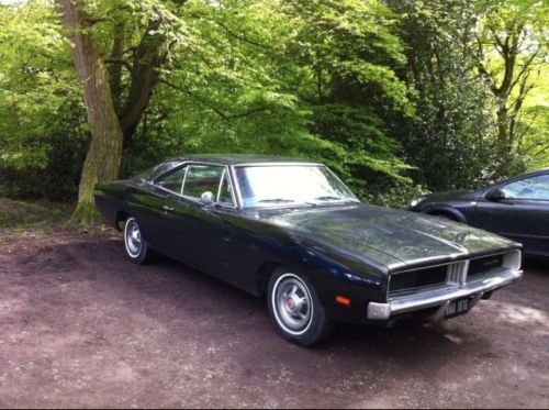

The first picture below the tires just look to rounded and small, no offense meant if it is a members car :lol:
Where the second and third pictures look kinda right to me, got that square wall shape.

Std hemi charger ran f60-15 which are 215/60x15-225/60x15 std chargers ran f70-14 205/75x14-215/70x14

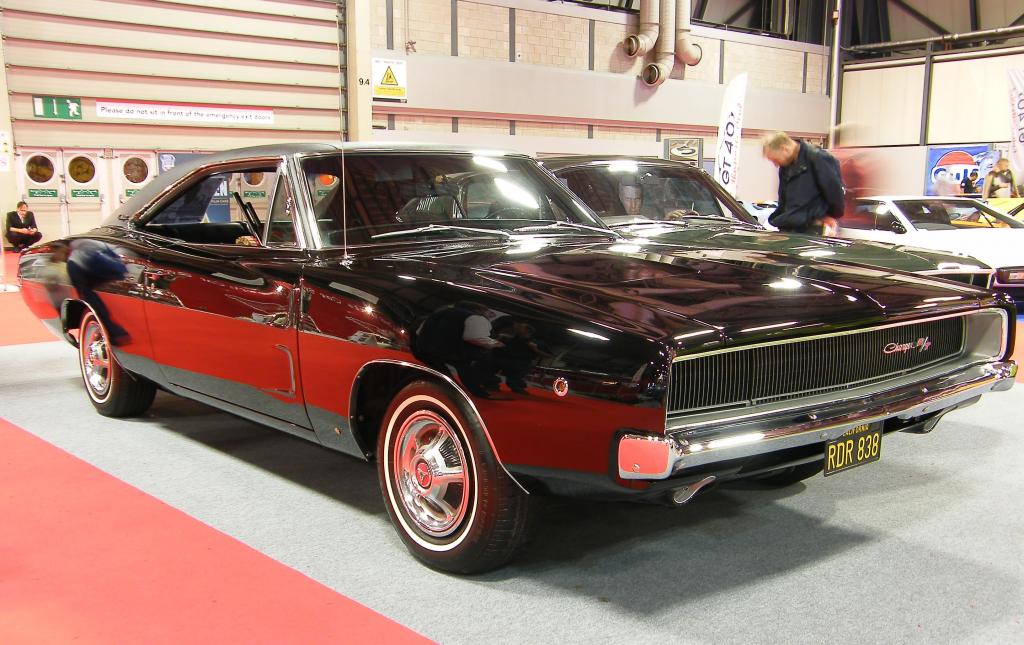

Don't know what happened there with order of pictures, but the look of tyre I don't like is the black Charger at the NEC, they just look to small and rounded.

Glen63 wrote:Don't know what happened there with order of pictures, but the look of tyre I don't like is the black Charger at the NEC, they just look to small and rounded.
The last photo looks to have a smaller side wall. They look a little small on it perhaps but then most have aftermarket wheels on now it seems?

I would go for some of these .....or maybe not quite so tall if you can find them...
http://www.ebay.co.uk/itm/4x-SUMMER-TYR ... 3f50b3e93e
I may be wrong but I think the wheels and caps in the pics are 14"....I don't think you can get that style in 15". I want some for my Polara in 15" and thought I had found a set but they were actually 14".
