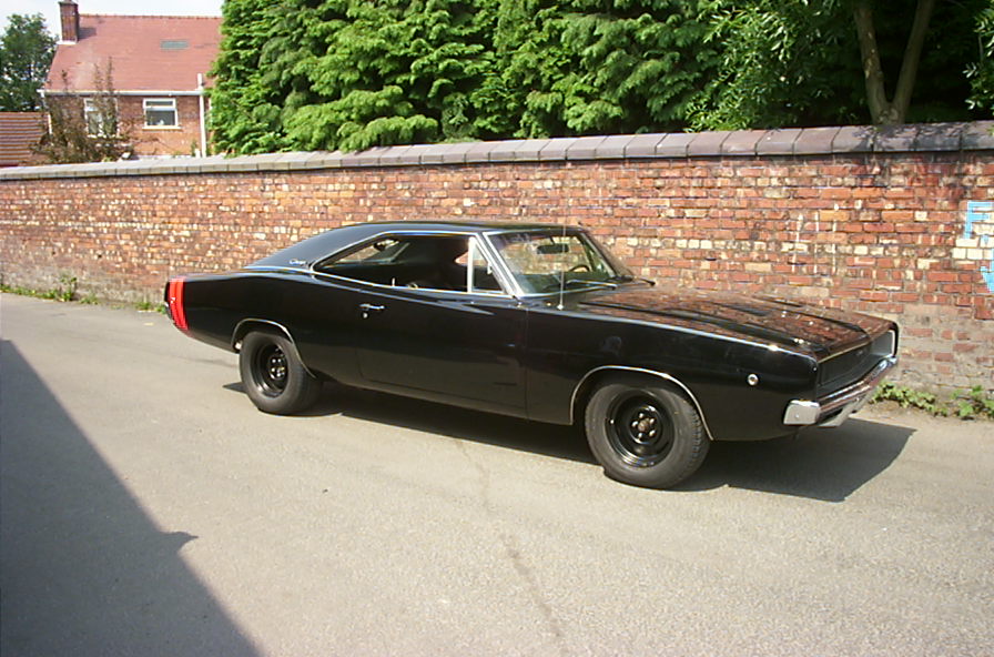

One I did earlier:
Proper car.JPG (135.16 KiB) Viewed 2407 times

Pete wrote:One I did earlier:
Ahem
Dave Madders 0161 428 4281
Posts: 22150
Glad you are paying attention, Mr Madders ;)
I could not be arsed to re-size the GL pictures I had at my disposal.
..but you get my drift. :thumbright:

did look hard as nails

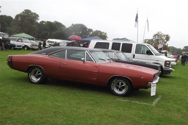

I'm the same as Pete for the rears but have got 235 on the front.
DSCF6931 (Small).JPG (44.01 KiB) Viewed 2380 times
Posts: 22150
Your Tiger Paws look a bit under-inflated.
What pressure are you running - this can make a big difference too.
