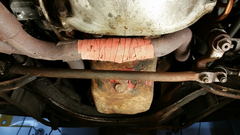

New carter carb needed
- 20151016_170809_resized_1 (1).jpg (158.71 KiB) Viewed 2313 times

Sammy, I would recommend taking Pete up on his offer to look, he won't give bad advice and knows his stuff. I can let him know exactly what I have and he will be able to explain all.
You can trust Pete, to be honest it doesn't sound like you can trust your Exhaust man!

2) in My opinion your exhaust should not be costing that much. Pull it out of where it is and get in touch with JohnR or Anton on here. Anton is APD automotive
here http://www.apdautomotive.co.uk/
and JohnR is a Marine and general engineer
Both are eminently trustworthy guys, based on experience and the fact I have known both for 10 years I'm pretty certain one or both can help you out with these jobs, obviously I have no idea how much they will cost but at least if they say its £750 you have a Nice person... someone one in the club telling you how good/bad it is
John has a day job but will take on other work time permitting.
Anton visits the forum just about every day John doesn't I have numbers for both
There is nothing here that would worry either of them. Anton will take delivery of a car on a trailer and has arranged delivery and return before
john owns a truck and has travelled to fix or picked up and taken away in the past
there would be delivery or travel costs I'm sure but I can't think either would charge £750 to weld up an exhaust.
