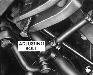

You can lower or raise the front ride height by turning the torsion bar adjusting bolts
You should really take the weight off the front end before you adjust them to make sure you do not damage the threads, especially if they have not been touched in a long while

(4) Refer to Specifications [model dependant] and adjust if necessary by turning torsion bar adjusting bolt clockwise to increase height and counterclockwise to decrease height.
(5) After each adjustment, jounce vehicle before remeasuring. Both sides should be measured even though only one side has been adjusted.

- adjustingBolt.jpg (25.57 KiB) Viewed 673 times
I have done it both easy, on the ground or with the car up on stands,on the ground you do risk breaking the adjuster,
but I have mine heavily lubed up with anti seize ,
and I also have the driver side a tad higher for driver weight,and that for me is 200 lbs, be sure to bounce the car ,I like to start the car and move it back and forth in the driveway and even down a curb to be sure everything is settled,just bouncing the car sometimes is not enough , and you will need to do an alignment after it is all done. also I measure from the pinch weld off the frame, because fenders can vary from side to side.
The instructions you posted here are straight forward, so follow them and you will be fine.
