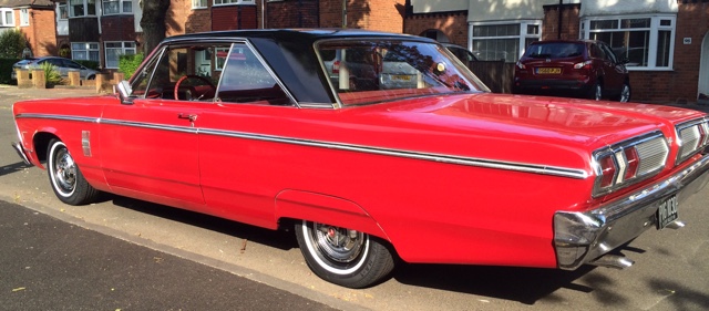

Lovely weather today and job done. We used a variety of pullers and g clamps etc to get all the old bits out and only had one really tricky part. We couldnt get the top bolt section of the rear shackle out of the hanger so we ended up just gently heating the top fixed end of the bolt and the heat transferred through and softened up the old rubber bushes. We then just slid it out and replaced everything after cleaning etc.
Took about 2 1/2 hours start to finish.
Thanks for all your help on this men
Cheers Steve and Andy :thumbright:

A big thank you to everyone for your advice and help, and also big thanks to Steve for helping me getting the mighty 'PUG' fixed. Just taken her for a retest and she's passed with only a couple of minor advisories.
Thanks again!!
Andy
Keeping "PUG" in the Club
1966 Plymouth Fury III
