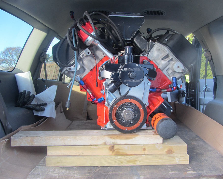

Yes, yes, YES!!! It REALLY has got a Hemi in it!!!! Just!
Hemi in a hemi.jpg (244.24 KiB) Viewed 10796 times

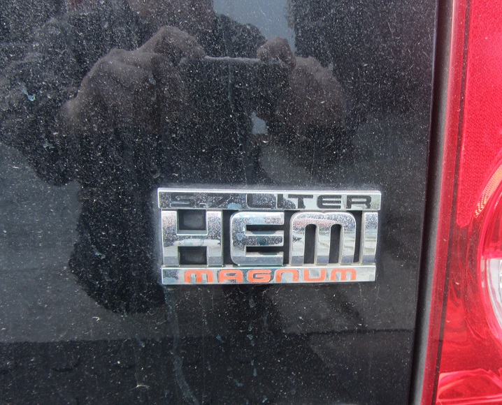

Yes, it HAS got a Hemi in it....
Hemi Badge.jpg (205.64 KiB) Viewed 10796 times

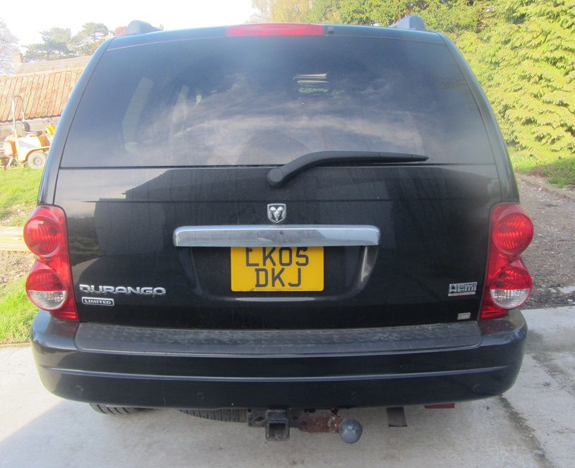

Here is old faithful after a trip Oop Narth....Bananarama! journey home mind you...

We hadto take the carbs off to get it in and it STILL did not fit.
Ended up taking the carb studs out of the manifold and it went in with a fag paper's clearance.
All dyno'ed up and ready for action.

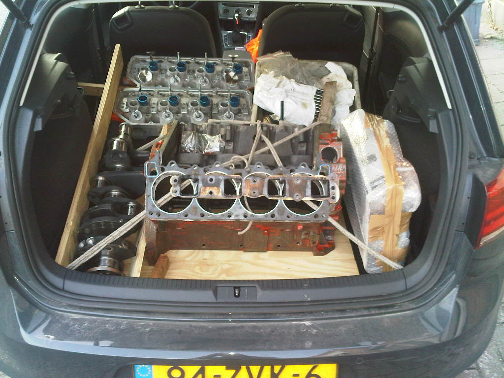

Had same issue.
But had 572 cui. Hemi in Volkswagen Golf.
Hemi in Golf
Hemi in Golf
Hemi golf.jpg (114.61 KiB) Viewed 10756 times

Post by Dutchrunner »
Assembled Hemi does not fit in a Golf.
Had to use transporter van.

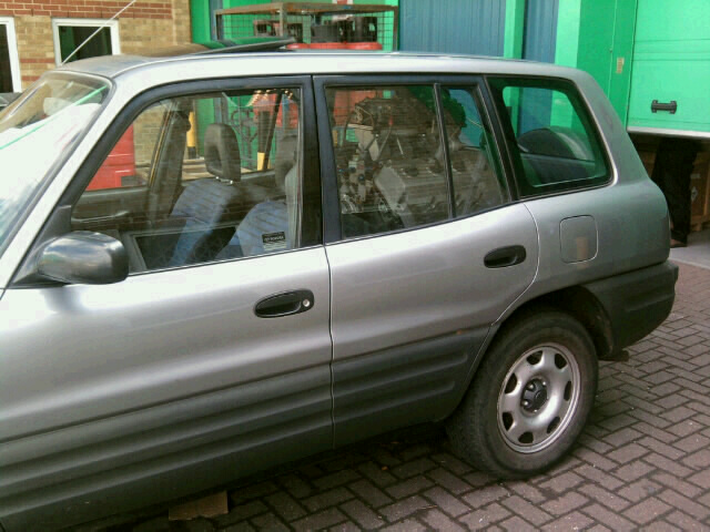

Well, we managed to get one in a Toyota Rav 4 complete with manifold and dominators, but you have to look closely!
Hemi in rav 4.jpg (115.98 KiB) Viewed 10691 times
