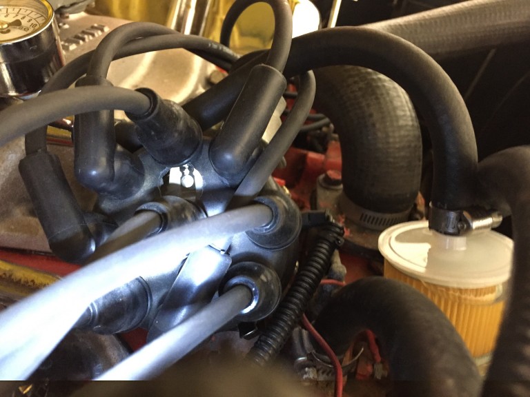

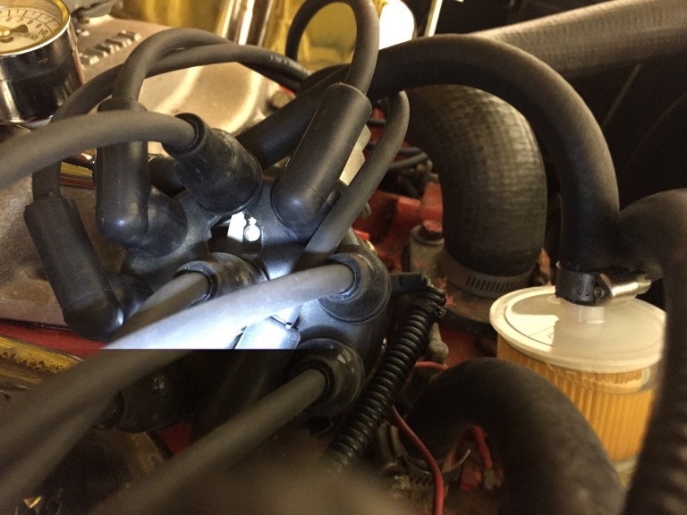

I checked the phasing tonight and it was spot on. I reconnected the vacuum to the dissy and the phasing advances a little. She didn't seem to pop through the carb though snapped her open and little. She Popped through the exhaust couple times, but I think that might be down to the old cap and rotor missing, now and then the light stopped working for a second
I was working in the garage so I couldn't run her for long without killing myself, but this does seem to be an improvement, she's still leaning out on the gauge though.
Anyone got a 38 squirter??
- This is with vacuum connected and a little throttle.
- image.jpeg (100.41 KiB) Viewed 2532 times
- Drilled the old cap and parked it and the rotor with some tip ex. This is without vacuum
- image.jpeg (107.11 KiB) Viewed 2532 times

I always work backwards from 34 Degrees fully advanced.
Then the fun starts to get enough timing in at idle.
I have a problem on the Coronet engine and that LOVES lots of advance and I will probably have to lock the timing out at 34 degrees, and then work out a "Starter Saver" mechanism to avoid starter motor premature failure. Easy with an MSD Digital 6.
The motor will always tell you what it wants...

Thanks for the replies guys. I'm gonna try her with the vacuum back on and take her out see how she behaves. I set it back to 18 initial tonight, I didn't measure how much the vacuum brought in but it looked to be plenty. I set advance on the gun to 18 and she jumped way back up onto the make shift timing tape I put on her.
I'm determined to get this all sorted for the summer. I'll keep you posted, might order a 38 squirter too
