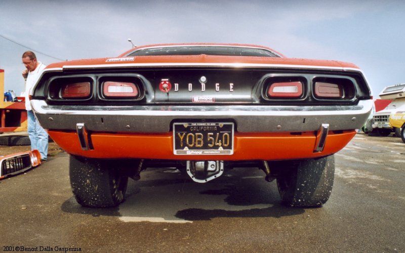

I stuck the slicks on a borrowed pair of rims and at the moment I do not have 1/4" space twixt tyre and car, so once again fortune has vomited on my Eider down; hence the post!

I know this thread is old now, But can you get scrap tyres to experiment with.
I have some spare wheels(mags and cop rims) if that helps, bit of a trek to get them thou :lol:
The wheel tire combo was a perfect fit Pete
Posts: 22137
It is now, big fella :thumbright:
