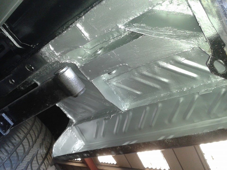

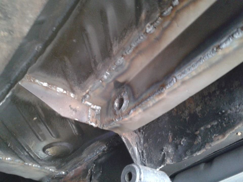

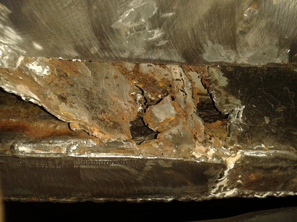

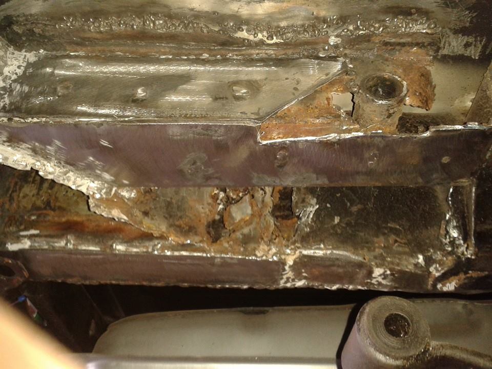

heres an example of a car that had a 7 yr resto, thankfully its liable for mot being a 68 but as ive learnt not all enthusiasts are capable of doing a good job, take the rusted chassis pics there after the resto !! the white bits you see are remains of bodyfiller i dug out covering rust or badly welded plates, check the welds i think someone was scared of sparks !! as you see in the other pics i fabricated new chassis sections,it really needed complete new rear rails. my point here is theres a lot of cars out there that aint right or badly repaired, the untrained eye would prob not notice this stuff, i do yanks,muscle,customs on a daily basis and am amazed of the poor workmanship thats still out there on the plus side it keeps me busy but i feel for new owners that buy these cars, for the people that dont do the job right the pre 60 rule is a godsend for them

I've seen one or two on here "welded" like that. People have no idea how to clean up,make templates and cut out ALL the rot or how to use their cheap useless gasless mig,which will never work properly.
