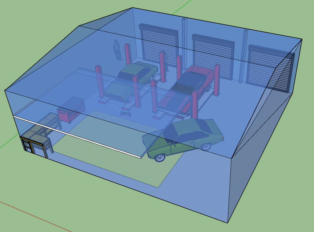

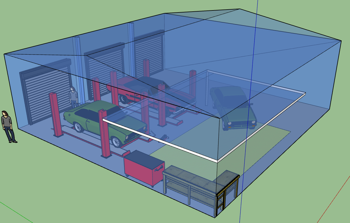

GJUK
Posts: 2486
Post by GJUK »
Maybe one of both. I'll have a play.
But would those on here agree the layout as it is (if the ramps, or at least one of them) changed to a 2 post works?

Posts: 7141
Last layout looks much better. Leaves you two spaces out the way for pure storage.
Just keep in mind headroom if your running the mezzanine like that as you stairs I would expected would run on the back wall.
With the power tools ect, in my head I'd probably have it running over the two spaces you'd use for car storage. Headroom and high storage at the apex.
It would also be beneficial for natural light in the working area and safety in doing hot work.
Bay one, tandem garage and mezzanine store.
Bay two and three as the workshop area. Lifts at the front as it is now. Mix of 2 and 4....best of both worlds.
Can see that as the best of both in me ed.
