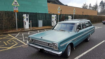

The old beast.....towing one of these.....
terryr
Posts: 2541
Post by terryr »
sexy wagon :thumbright: them fold up caravans always remind me of a flatpack Anglia
