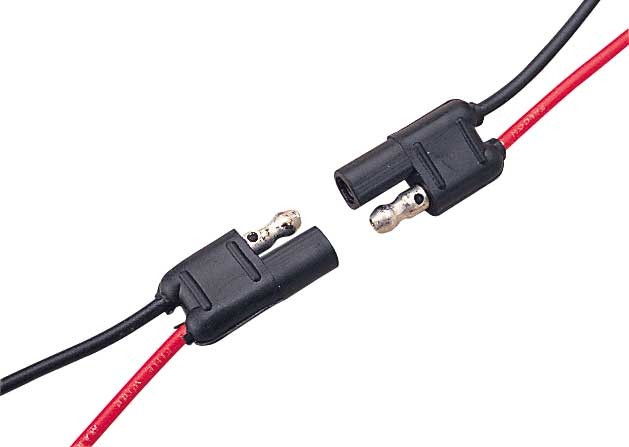

I had the same sort of thing, even the backfire when you let go of the key, mine turned out to be, click the link. http://www.moparuk.com/forums/viewtopic ... ight=derek

this is worth a check as i had a break inside the rubber block to the distributor, had nothing on cranking but would fire as you brought the key back and sometimes a backfire and then other times fire straight up !!

I bet that took some finding, Jim. Thanks, I'll check that too

it certainly did !! replaced everything electrical, then took whole engine bay loom out to check every wire at diff points
