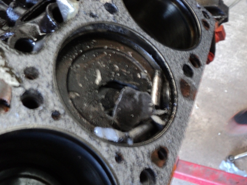

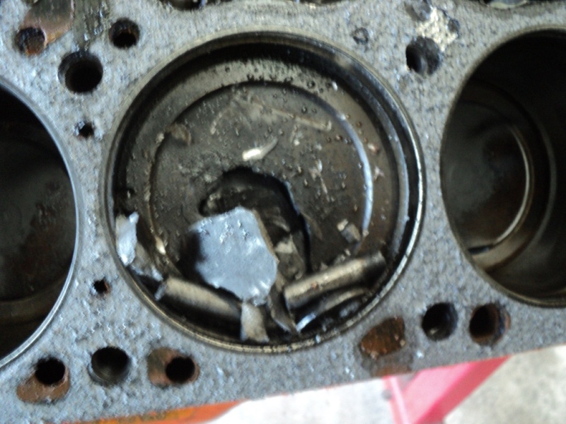

Last Friday I fired her up to move her back into the workshop, and there was a weird bang from the engine. I shut off immediately and we tried turning the engine over manually, it was tight.
We pulled the plugs and the first 7 were fine, the 8th didn't want to come out!

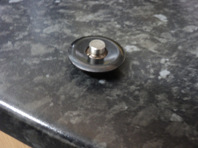

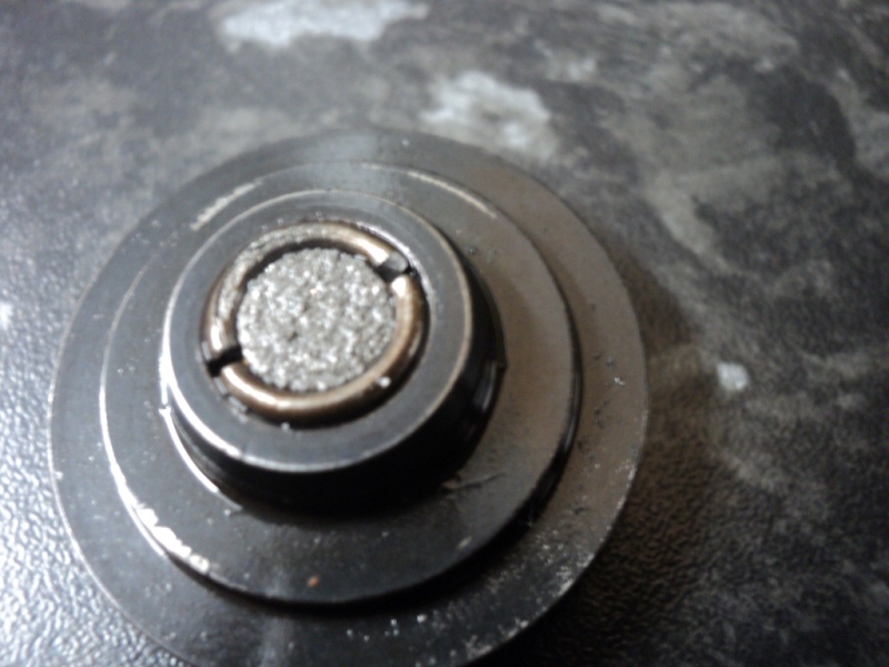

When it did come out the end was smashed to a pulp!!?? We took the valve cover off and found that 1 valve had snapped right under the collet and the rest was getting acquainted with No.7 Piston!
On removing the head, we found a completely smashed piston and a cracked bore :x :x
But...things happen for a reason, so I now spending some proper money and Mr Billadeau is building me a nice 408!

hi kev. how gutted you must be having done all that work. sorry to see the results too. but im interested to know . did you work out how it happened. what I mean by this. how did the valve make contact with the piston. especially as you had this motor running sweet and with no problems to start with. I ask this for all of us who like to build our own engines. and maybe safeguard ourselves from similar issues. im engine mad too. and always rebuild my own engines on whatever im restoring. hope your next motor offers you no problems next time you rebuild it. regards reggie

Bugger, from the picture it just looks like straight forward metal fatigue, just bad luck I guess.

Dave B did the analysis and I am probably not going to explain it as well as he could, but the aftermarket Com Cams valve springs were correct for the cam, but they were recoiling before the valve reached it's extent of travel causing the valve to snap, he says it was about 150 thou out.
Dave - if you read this and can explain better, please do!
If we had rebuilt using standard parts all the way through, we would have been fine, but the lesson I have learnt is if you are going away from standard either ensure you fully understand the tolerances or leave it to someone who does!

Do you mean "Coil-bind"?
I have seen that recently on an expensive car with an engine built by another "expert".....

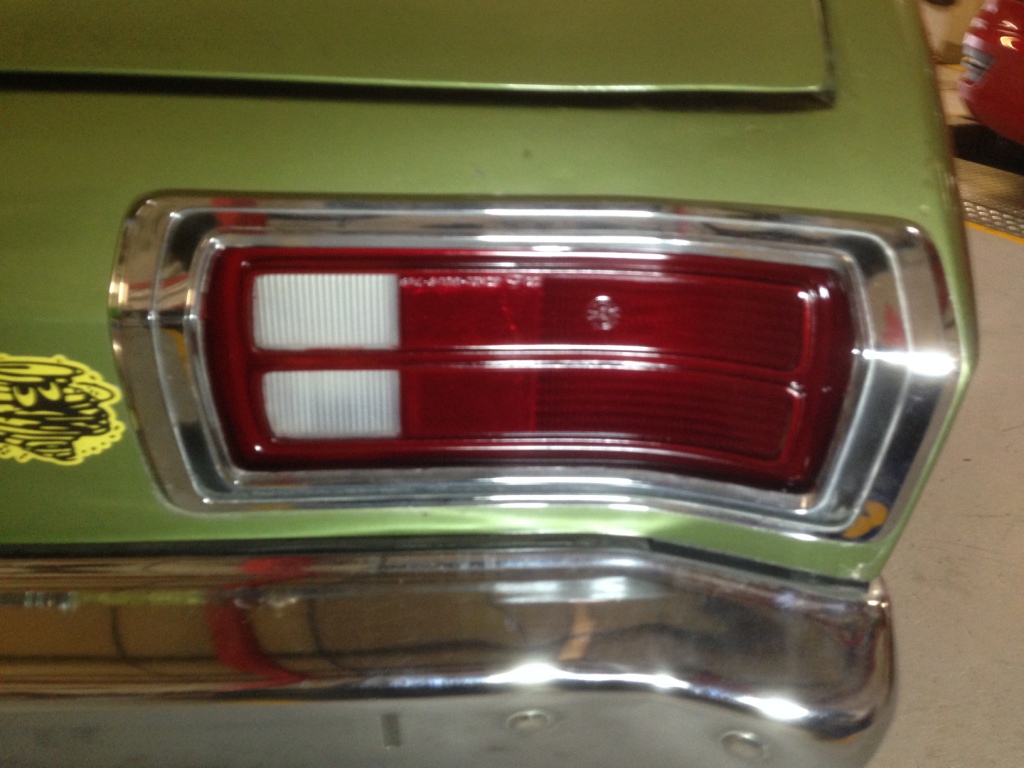

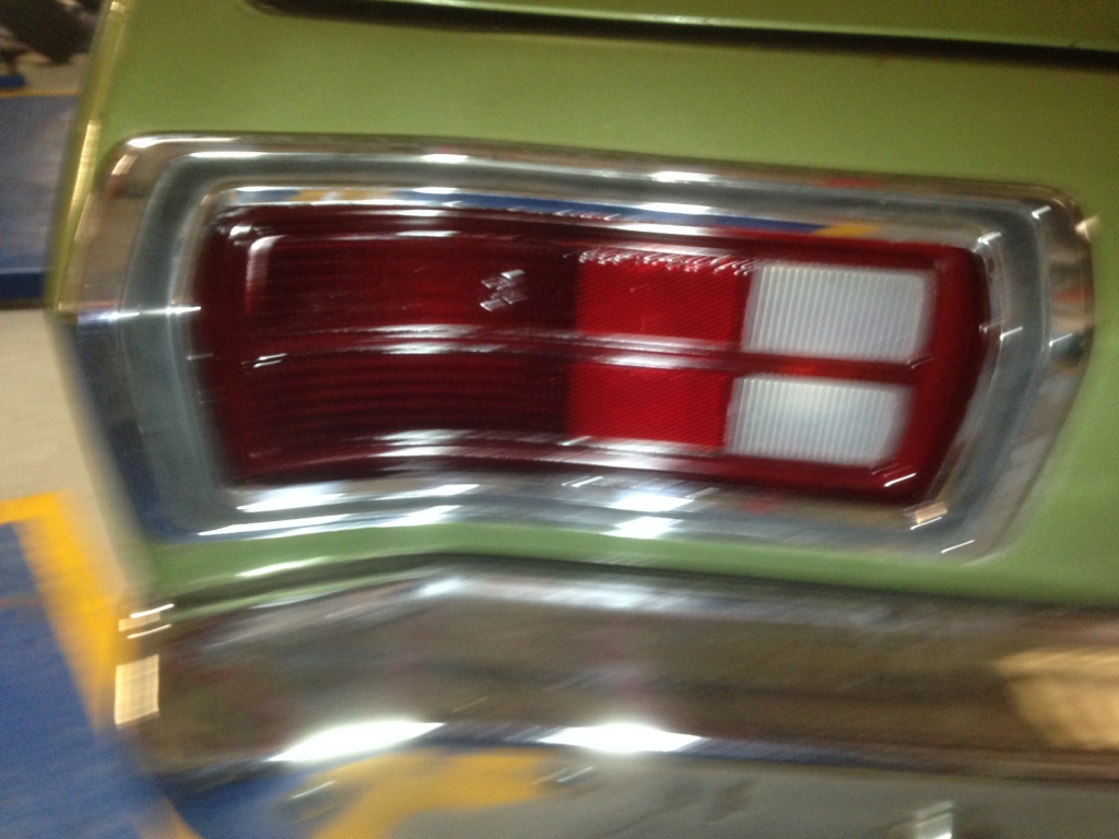

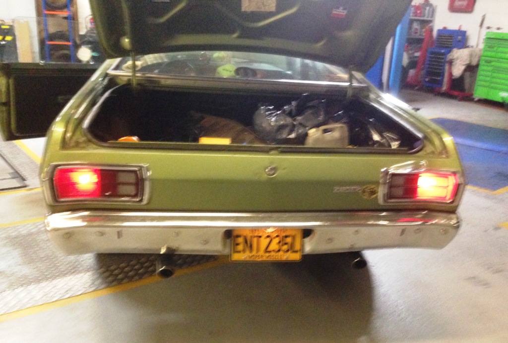

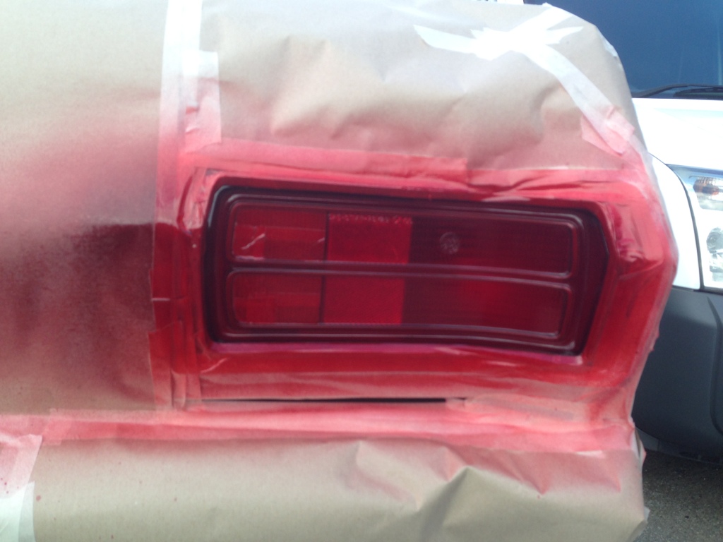

Hi All
The back lights on my duster have always frustrated me a tad, because the offside one is virtually pink (faded) and the nearside one is proper deep Red.
I came across VHT rear lens paint and I have to say I am very impressed.
After very careful masking, I gave both lens a few coats and then applied a couple more to the offside one until they looked even.
I followed this with a couple of coats of clear lacquer and the result looks great.
Apologies, one of the pics is a bit blurred.
Cheers
Kev

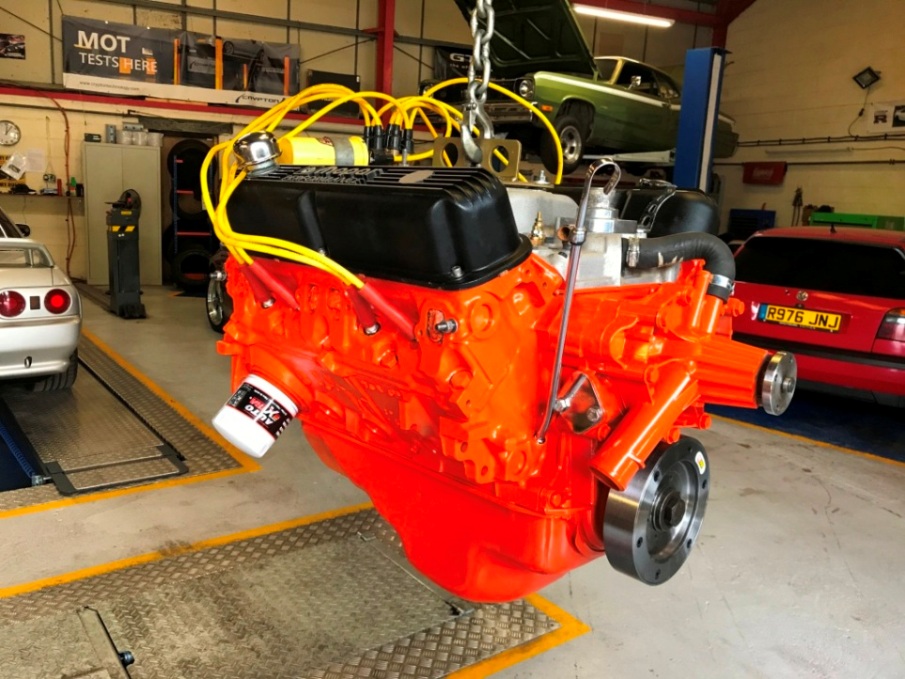

Hi All
I collected my freshly built 408 from Mr Billadeau on Saturday.
It looks awesome and made 416hp on the dyno, and 482 ft lbs of torque.
Just need to find time to get it fitted now so I can make the Nats!!
