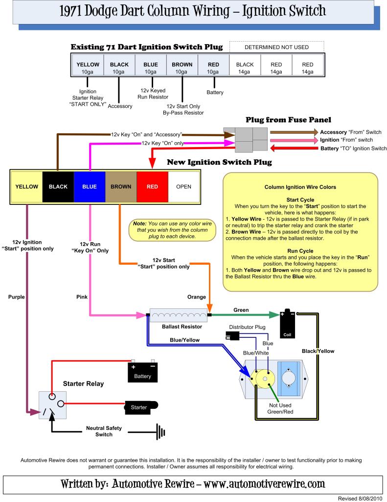

I'm enclosing a thread that shows the two switched I have as mine are identical and you can see wires are different as to where they connect on the switch.
http://www.forabodiesonly.com/mopar/thr ... rk.372468/
This diagram shows the correct wiring
i
MilesnMiles
Posts: 7309
Location: Cornwall
Post by MilesnMiles »
Am I right in thinking that the yellow to starter should only be live for Start/Run 2 and should be coupled with the brown wire? As the car starts, the voltage to those wires should drop out

yes they can be coupled together but when the key returns to ign on they must both go dead.
Brown is cranking live to coil side of ballast to give full 12v to coil but once car starts is should go dead and power to the coil must go through the ballast resistor.

are the switches the same or do they look like the switches in the ForAbodies Only thread?
if they differ you have 2 choices
1) side by side with a bulb battery and 3 bits of wire work out what each position does
2) get the wiring diagram for the later car that that new switch must come from and work out the colour equivalents
then you pull the wires from the connectors and put them in the correct order for your loom
my indicator switch was the same. pattern part colours made no sense and connected in slightly different places.
