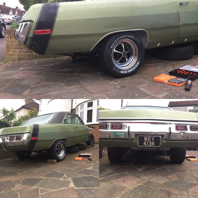

Will do, I was planning to get them from there. I'm going to see if I have some tyres at work in the size I think will fit, push the cardboard wheel into them and slowly lower the car until the tyre barely touches the floor and check the clearance. I think based on my measurements 225/65/15's should work

This is on my 72 Dart Currently:
205/65/15 Front
235/60/15 Rear
Reality is with most Mopars the Diff is not centered.
235s fit perfectly without rubbing.
On the one side im sure I could have got a 255 in but not on the Passenger side.
The wheels are 15x7 in Steels with 4" BS.
Posts: 22212
My Dart ended up with exactly the same - Or I too could have run 1 x 255 and 1 x 235!!!

Dave I like the stance of the dart, thanks for posting the picture. I made a cardboard tyre tonight as well 235/50/16 and the clearance looks spot on so I think my decision has been made!
Thanks for everyone's help, input and advice.
Blue, sorry to hear about Northants I spoke to someone there called James earlier and he was really helpful, recommended tyre sizes and wheel options and seemed really knowledgeable. If I didn't use them can you offer any alternative suppliers?

Just to give you all an update, I ordered the wheels & tyres with Northants yesterday mid morning, the prices on the website matched what they quoted over the phone. They arrived at my work, tyres fitted to the rims before 9am this morning.
Only small problem was that they currently didn't have the centre caps in stock that I wanted, not a problem I can wait.
So as long as I've measured them correctly and they fit I'll be a very happy customer.
If not there will be two wheels and tyres in the for sale section of the forum later tonight :lol:

Well they fit, and I think they look pretty good!!

Sorted :thumbright:
Posts: 22212
Good news! 235's??? ;)

Yes Pete, 235/60/15
