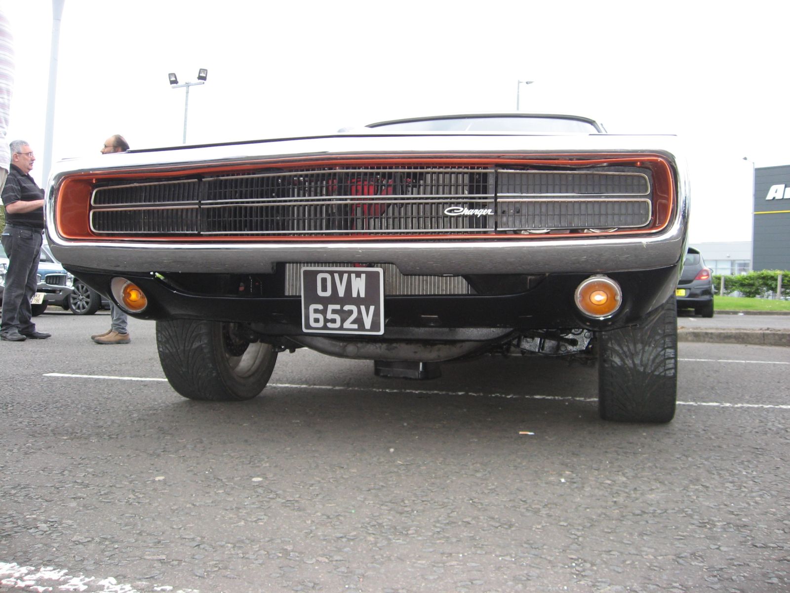

Armour plated sump.... :)
Nice to see you and the car this evening, Barry.
