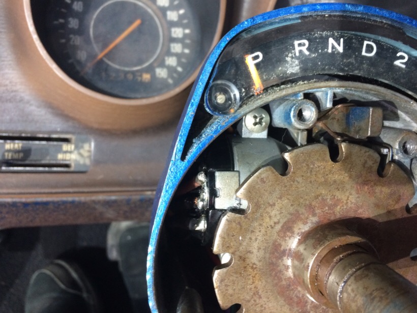

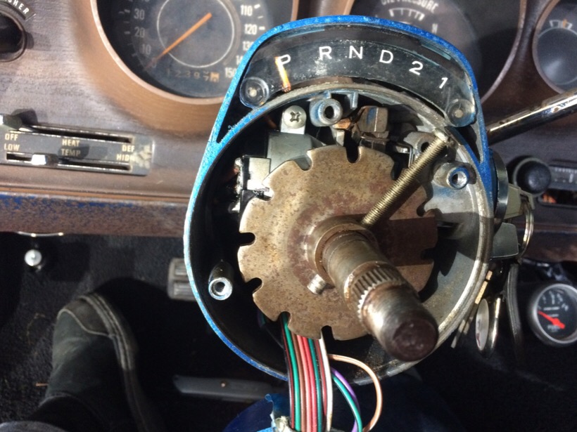

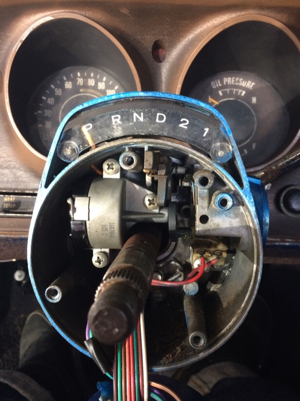

So I decided to replace the ignition switch. This is not a short job. Lots of parts to remove but besides a three leg puller nothing special needed.
I had to drop the column so as to get the switch wiring and connector block out of and then into the headset area which is a tight fit.
After much time test fitting I finally started to put it back together only to find that the steering lock hits the new switch :evil:
There's no leeway for error so I assume that the aftermarket switch is a fraction bigger than the original one and so I had to settle for removing the steering lock otherwise it catches badly on the switch and would soon gauge a chunk out of it.
Don't need the steering lock, but getting that ring on and off and trying to get the very tough oil in and out is no fun.
Next step is to adapt the wiring to accept the new ignition switch, it's not just a straight swap and plug and play. More fun
:? to come.

Pete, it's easy enough to do. Driving that pin out is a bit tricky without hitting the housing but once half out I used molegrips to close the split part of the pin and out she came. I then used a puller and the ring came off easy.
Has to come out to get the switch in/out.
