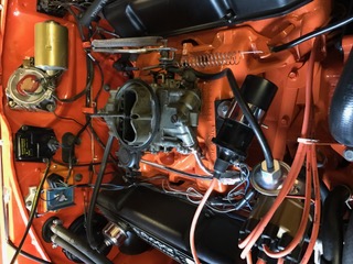

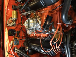

I recently decided to change the carb on the 70RR for a brand new 750. My old 750 was fine but ran a little rich but mainly grubby looking. It took about 30mins to swap over, however there is now a serious lack of power, it's as if the secondary is not opening, when hot it idles fast and in now runs on. I checked the timing and that was fine on the plus side the smell out the pipes is better, is there anything obvious that I might of missed that would cause all these issues simultaneously?
