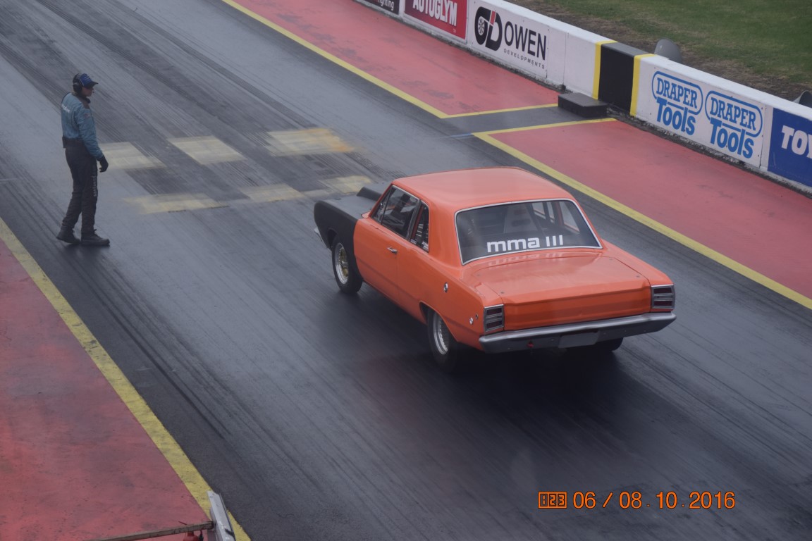

Hi all, just wondering what pressure you can ACTUALLY run street tyres at?
I have 165/80 R15 on the front of the Dart and they say 40 psi MAX. Do we think this is for road grip/handling purposes or "dont go any higher or they will blow up in ya face" reason?
Any thoughts would be great, cheers :) :)
DSC_0037 (Medium).JPG (177.25 KiB) Viewed 1355 times
