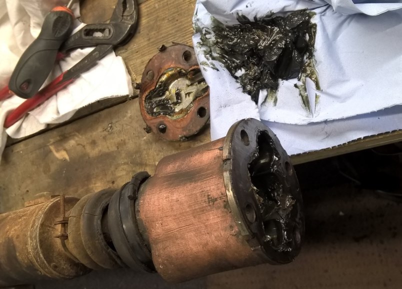

What do you know about trunnions?
Posts: 8369
How much wear is acceptable? Are they repairable/ replaceable?
I've cleaned it out and regreased it and repaired the boot.
Trunnion stripdown.jpg (157.16 KiB) Viewed 1713 times
Dusty Trunnion renovated.jpg (148.82 KiB) Viewed 1713 times
Posts: 14656
There shouldn't be any slop in it, it will cause a vibration when it's worn too much, assume a prop company would be able to repair or replace, it's not an MOT issue.
Posts: 8369
There's very slight side play. I do have a vibration that feels like the prop so it's likely that as I've replaced the uj at the other end.
Cheers Blue

Hey Mike, any chance you could take a photo of your prop?
I've asked at Proptech who made my Belve prop and they can do it but unknown timescale and unknown price until I send it to them!
I need a plan 'B' :?
