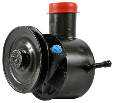

Power steering pump pulley removal and refit

Can anyone give me there knowledge on the process. :read2: :help:

You will need a puller to take it off and put it back on, there is a tool for this.
https://www.2carpros.com/articles/remov ... ing-pulley

Cheers Derek my problem was the fitting but I see the new ones come with a thread in the centre of the shaft where as the old unit does not.
