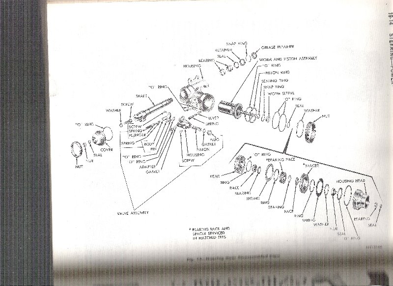

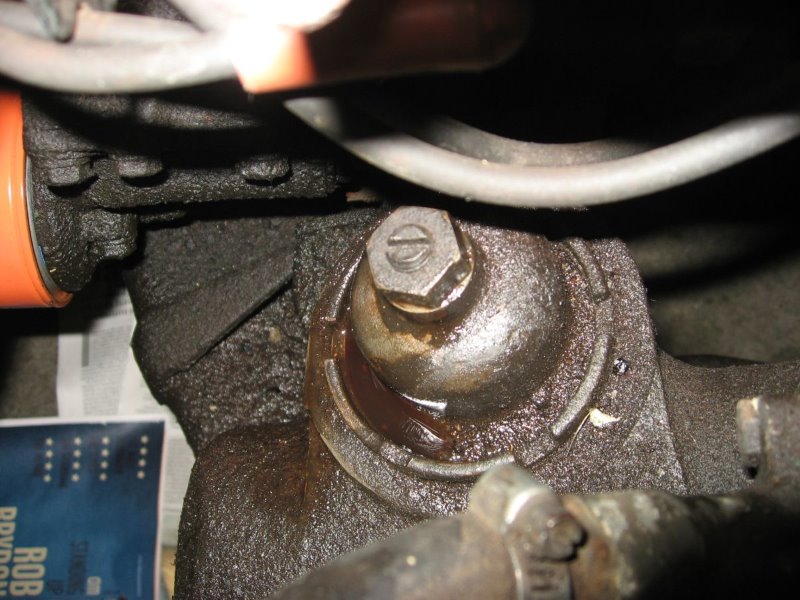

Seeking some technical advice on Linda's Monaco if possible? I had it out today at the Tartan tarmac event and noticed oil leaking out the bottom which appears to be coming from the top of the power steering box (see photo). I checked the pump reservoir and it was a bit dry so I topped it up, cleaned it all up and when I got home, checked it again which is when the photo was taken. I looked at the service manual and it appears the oil is leaking out of the cover (to the left in the illustration) and, I hope may just be coming past the seal third in from the left. According to the manual this is a square section seal (is it available?) but can it be accessed only by loosening the nut, or does the cover need to come off? And if the cover need to come off does it require the special nut socket and can it be done while the steering box is in the car?
Any advice appreciated, or, is there a bodgy fix?

i think the cover needs to come off
the nut is a lock nut
it holds a threaded T shaped pin in at a specific depth to ensure mesh between sector and ballnut teeth
i.e record how many turns you need to wind off the nut.
you can bash that sectioned lock ring off with a wooden or aluminium rod and a hammer
you will need to wind off the cover and not let the pin and its shim fall out of the clevis end of the sector shaft
the cover might have a seal that is rendered useless by this action
another option would be to dump the fluid and fill it with some old style mineral oil based power steering fluid and see if it fixes itself
mineral based stuff has seal swelling properties
modern stuff is for modern neoprene seals. i.e seals that don't swell so the stuff in the fluid that swells seals is not included.

Re: Steering box leak
Many thanks, Dave.
Close investigation revealed....the lock nut had loosened
No idea how that happened. I took it off and the seal looked good underneath. Put it back on and tightened it up.
No leak. But puzzled how, after 14 years, it loosened off. Need to keep a wee eye on it.
And, if anything, the steering feels nicer now too.
