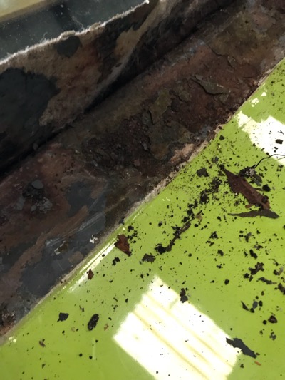

So, today I had to bite the bullet and peel back the vinyl strip below the back window of the Chally, and I’m glad I did and didn’t leave it over winter.

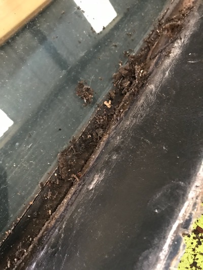

What I found was, well, in a word ..... SOIL !!!
Whatever plant matter and water had slipped below the back trim was happily creating a fertile and unctuous bed of soil under the rear window ..... oh yeah, and rust !
Cool thing is the vinyl peeled back and I’ll be able to replace it after a bit of sanding, filler and painting.

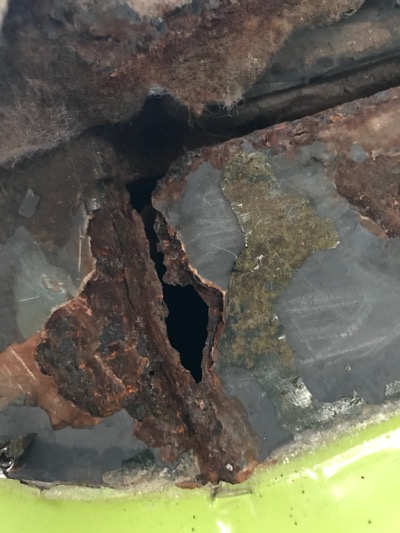

Overall, although I have a hole of two, I believe I got there in time - had I left it over the winter I believe it would’ve been worse.
Can I fix the two holes with glass-cloth and PR15 bondo type filler? I guessing that cutting out and welding in would involve rear windshield removal?

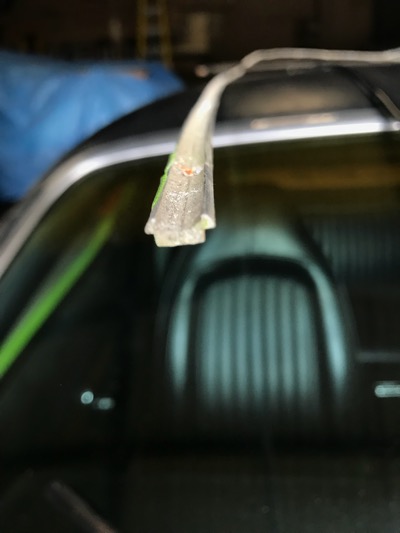

Secondly, can anyone identify the ali’ trim piece - it had been riveted on and has a black plastic press-on cover - I don’t think they’re Chrysler products and I feel I may have seen them on a speedboat before - that’s what the last owner used and it looked fine.
Also, the retainer clips are rusted out, I know I can find more on the web, but as they were not actually attached to anything (or it had rusted away) what is the piece that holds this clip in place?

Rear Screen is bonded in so a professional job really.
A new Dutchman panel is really the way forward, ditto new trim retaining clips.....

Clips are fun! The bits that hold them are small mushroom rivets / screws that fit in whilst the screen is out, then the clips fit into the screen chrome surround and pop on. I managed to order them easily on line from the states and they came in a small jiffy bag. I can't remember the supplier but will try to find the details. They were very good. Bear in mind 70 trim clips are different to 71 on !

New duchess panel is the proper way to sort this, you might get away with derusting and fibreglass etc for a year or so, but it will need sorting, but you may not need to replace the vinyl too.
Dave Robson years ago peeled his vinyl back, did the repairs around the edge and then put it back.
The more you peel, the more you will find, especially once you get to the roof seam on the C pillar which is a long leaded joint.
