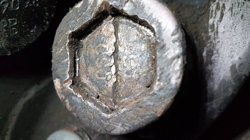

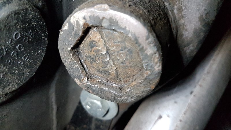

So, I've read about as much as I can find online about refurbishing the front suspension and made a start yesterday.
Everything was coming apart nicely until I got to the torsion bar. It doesn't appear to have the circlip in the rear mount. The pic shows the rear mount. Is this where the clip should be? Is so, and it is missing, what's holding it in?
Posts: 22150
Re: Front end rebuild question
It is being held in with the load on it imparted by the Control Arm.
In reality you need a Torsion bar removal tool to do it properly, but if you are lucky you can use a pry bar on the Lower control arm to get things moving.
If you look carefully you will see there is a groove for the Circlip at the back of the housing on the Gearbox Cross member.

Thanks Pete, I did think the grooves were for the clip. The mount looks a bit battered, hopefully they've not peened it over to hold the bar in.
Looks like more shopping for me then! :roll:
