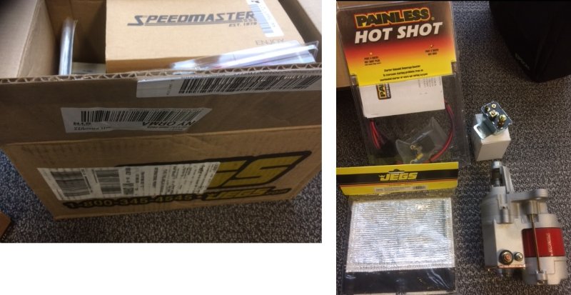

Ordered this on Sunday. Look what postie just brought ! Thats not bad is it ? 2days from the USA ! True, I bought the wrong starter motor and accidentally got a hot-start-kit but hey - I'm gonna go with it. It'll be better than the one I've got. So, starter, heat wrap, new relay and *maybe* the painless hot-start-thingy. Job should be a good 'un...

whats up with the starter
looks like a denso to me....
if the wires don't fit you can get a range of attchments that bolt on to whats there and present the connectors at a different angle to the cable
might keep it away from the headers...
morgan
Posts: 4227
Re: Unwilling hot start
Post by morgan »
Oh its fine; it looks to fit. attachments are the same.
I meant to buy the $120 one and bought a $63 one instead as part of a pack (heat shield, painless and starter). Hence I dont know if I will do the painless thing or not. If it works, its cool...
