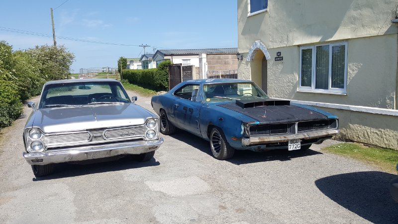

ive bought the 66 plymouth fury sport as advertised this week on ebay im hoping to use the 440 engine and all the goodies, disc brake conversion etc to put into my 69 charger ,would the back axle fit and what problems shall i face,im going to put the 318 from the 69 back in the 66

I can help you with what will fit / measurements as got a 66 Fury and a 69 Charger here to compare against. Im buggered at the moment as Ive fractured my foot.

i hope your back to full fitness soon,Ill be heading down to cornwall in approx two weeks so ill have both cars here in the workshop
the main reason for the purchase was the 440 engine,gearbox and axle if the brake disc conversion fits even better if not it will be put on the fury and ill source a kit for the charger thanks for your interest
