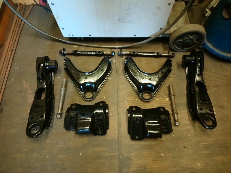

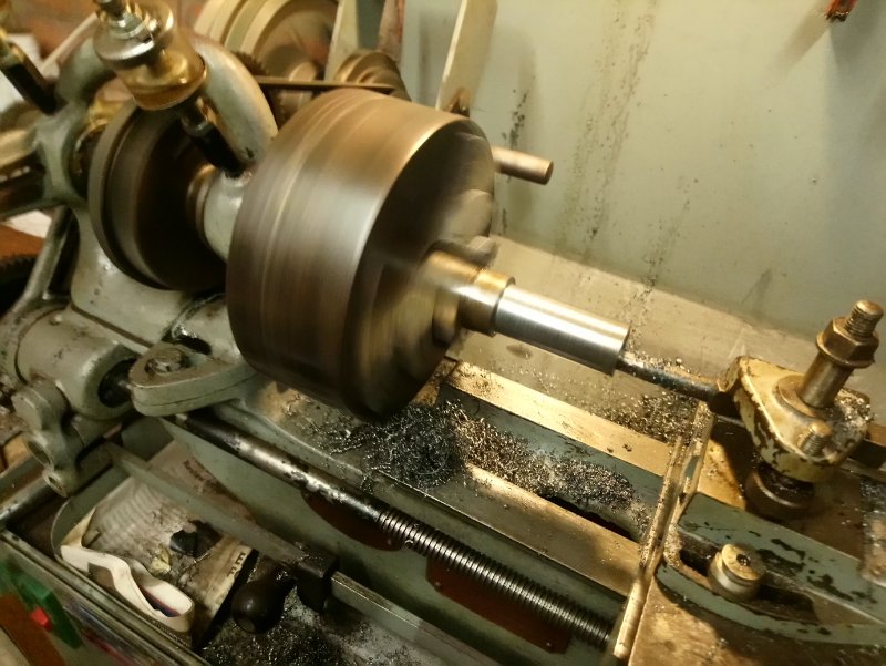

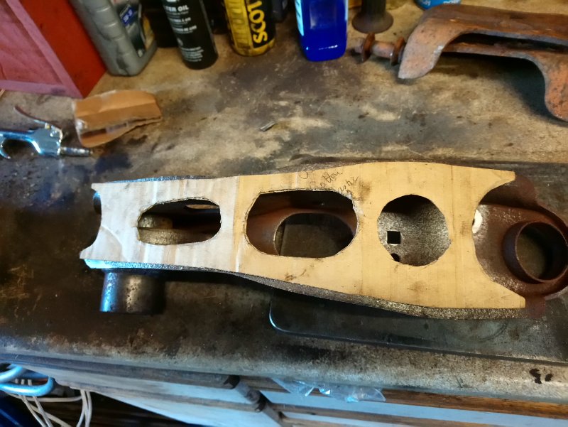

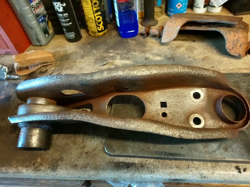

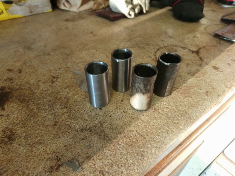

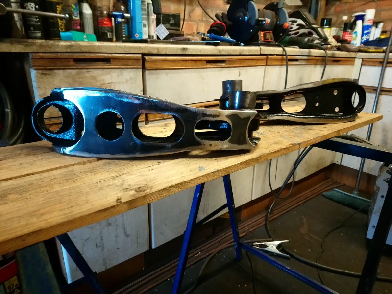

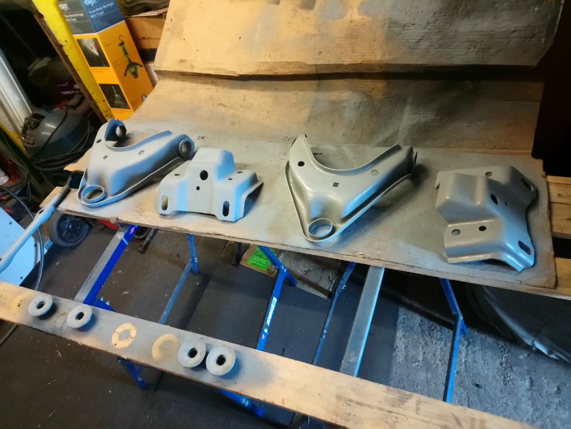

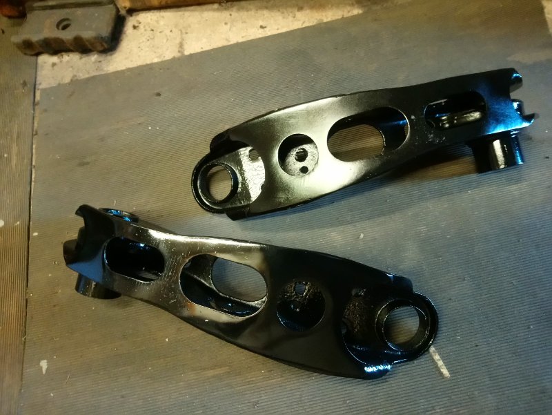

Been working on the front suspension lately, stripped everything down for a clean and repaint and decided to make my own Lca stiffening plates while I was at it. Also I'm going to Poly bush the front end and the instructions said to reuse the inner sleeves of the Lca bushes, errrr don't think 🤔 I like that idea... made some new ones instead. Last pic is new vs old.

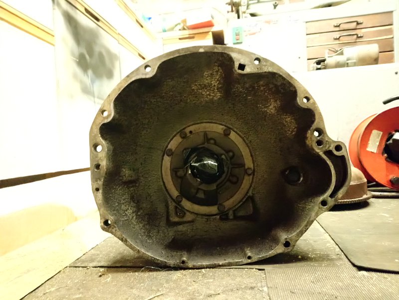

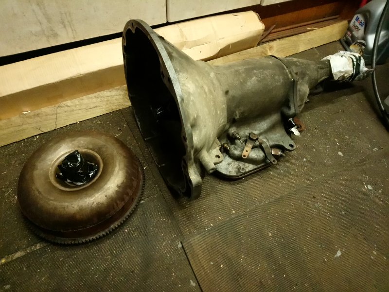

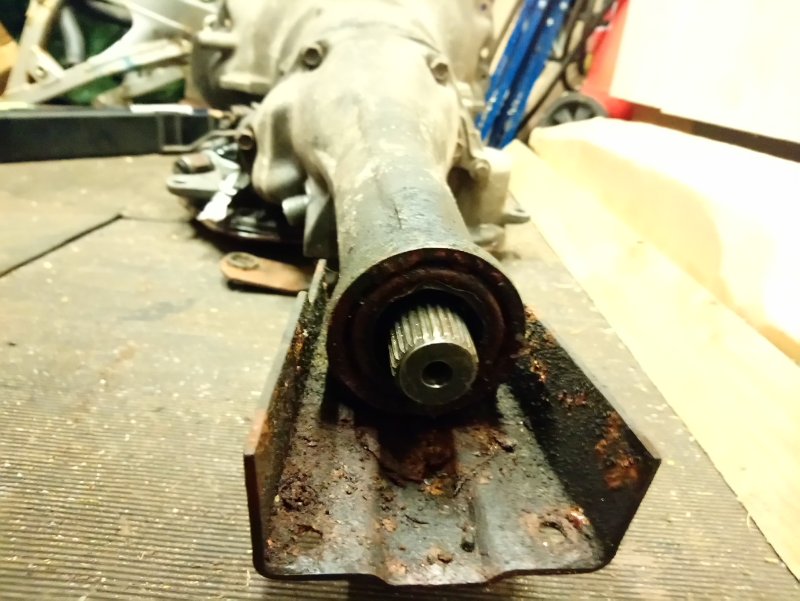

My mum's popped down from the island for a couple of weeks and she's brought me a pressie.....
One auto transmission now sits on my garage floor :)

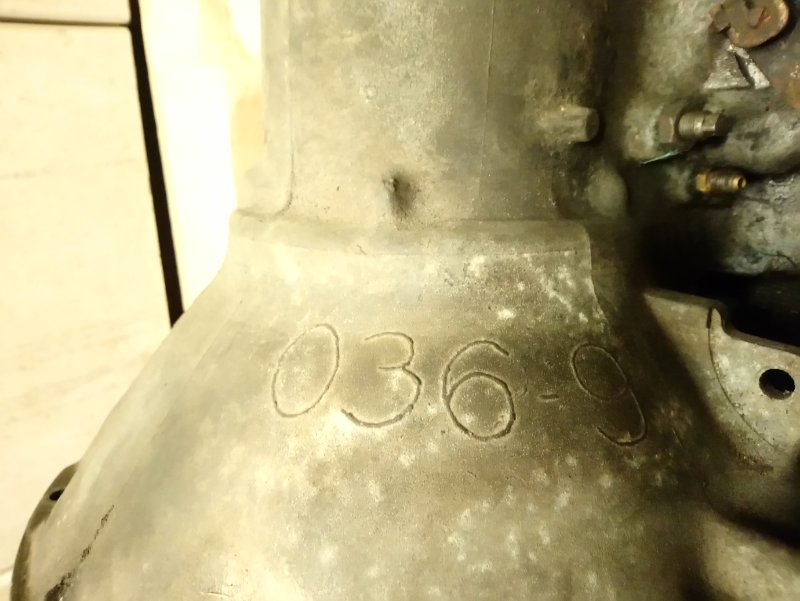

What do the numbers on the bellhousing relate to?

Love the LCA strengtheners--they look better than the ones I got from P.S.T
Could have done with the nice sleeves you made??
Lovely job

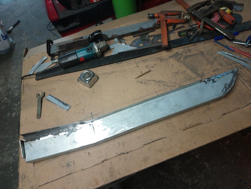

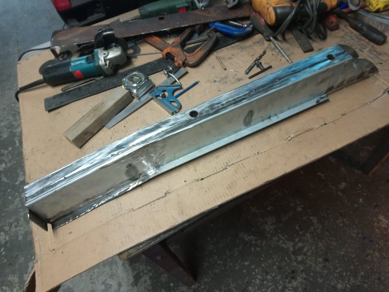

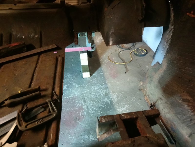

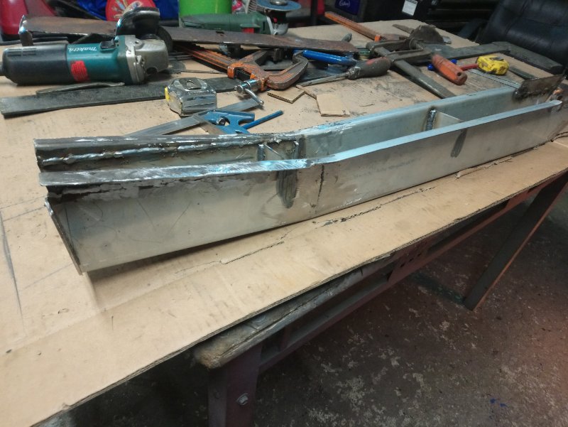

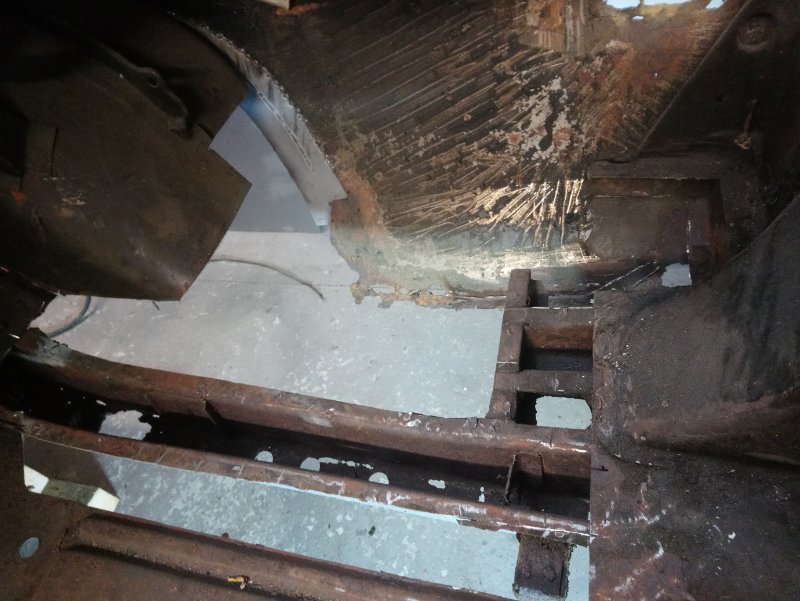

Small update, made a start on the o/s rear chassis rail which was beyond patching. So it was cut out and a template drawn up. I'd had some Z sections folded back in March so we set about marking out and shaping.... B****cks cuts were on the wrong side #-o #-o #-o
Now we had originally planned for changing both rear rails and had enough prefolded sections for this. So we spent a good bit of time inspecting the n/s rail and are happy it's solid and does not warrant replacing.
Phew back to shaping the o/s rail with the now spare material.
Two sides were made which were then clamped in place and when happy with the fit, tacked together. The rail was then removed to be fully welded and a couple of drain holes added.
We now have a assembly ready to fix in place Monday, it's the Sabbath here so no noisy work today.

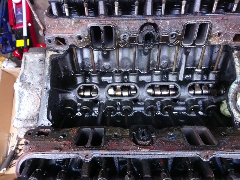

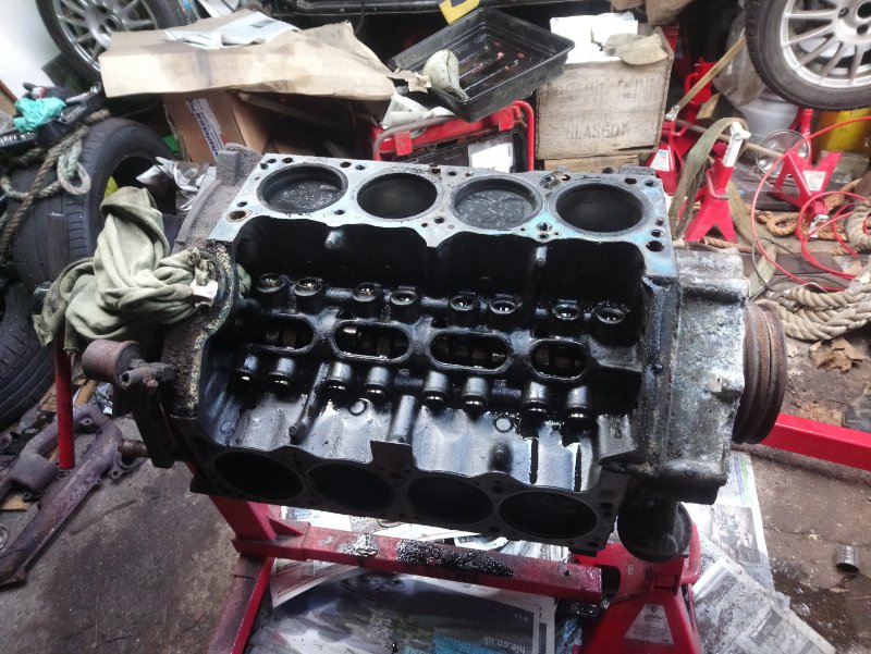

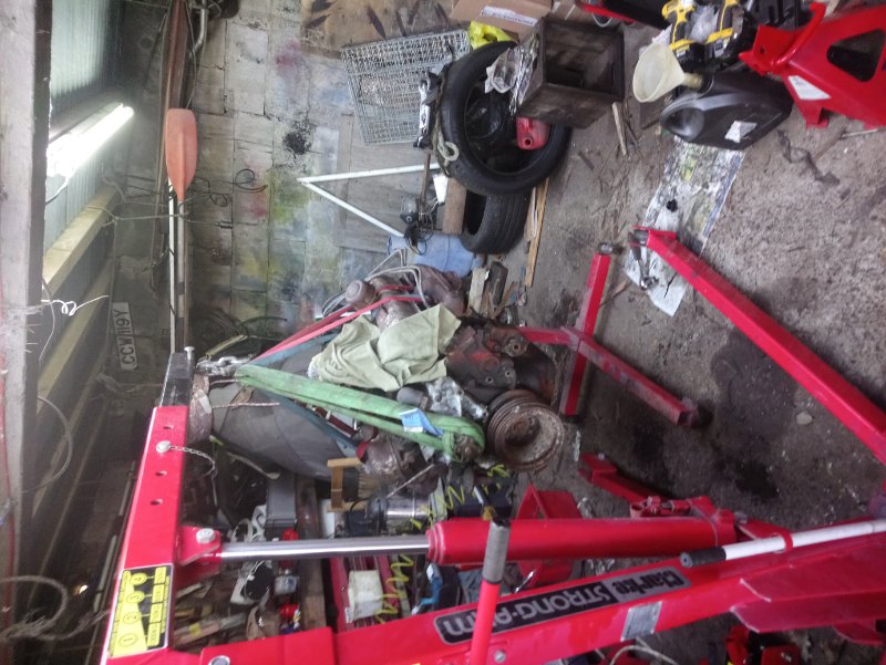

As its a quiet day here on the island it was decided to strip the engine down. This was for a couple of reasons, first was to gauge its condition and secondly to make it easier to throw it in the back of my daily and bring it home.
Considering how long and where its sat I'm happy with the condition. Although it has raised a couple of questions... :-k
