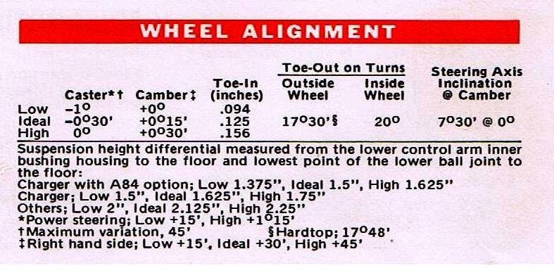

Posts: 9585
Re: Alignment settings
alignment specs that work with an aussie charger
might be of relevance
chrylser alignment .jpg (83.78 KiB) Viewed 3068 times
