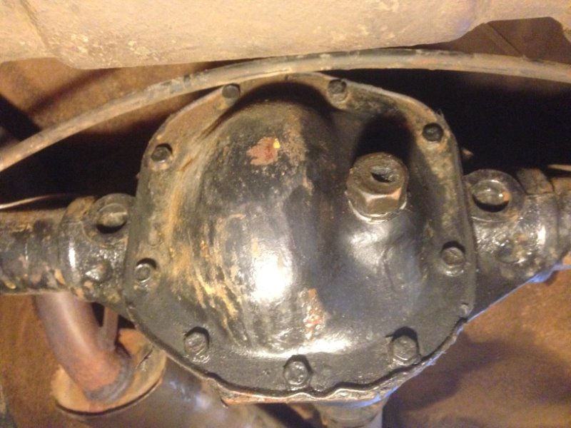

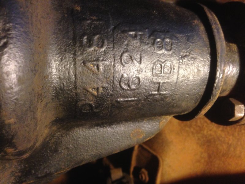

I thought the axle might be a Chrysler 7.25" because of the shape of the diff cover, it has 2.5" axle tubes and roughly measures 55" between the back of the flanges. It doesn't have a drain plug, but the only numbers I can find are cast onto the underside of the pinion housing (snout). The numbers are:-
P448
1624
HB8
Dave I would be interested in buying an axle from you, although the thought of ordering the wrong parts for a rebuild scares me a bit. If you have a good usable rear axle that doesn't whine that would be great.

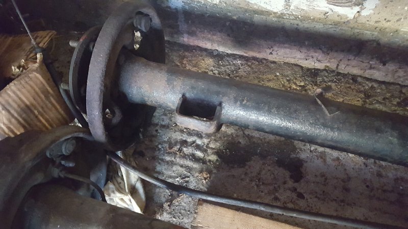

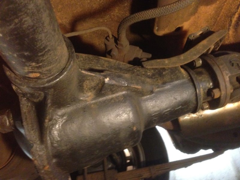

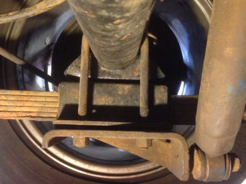

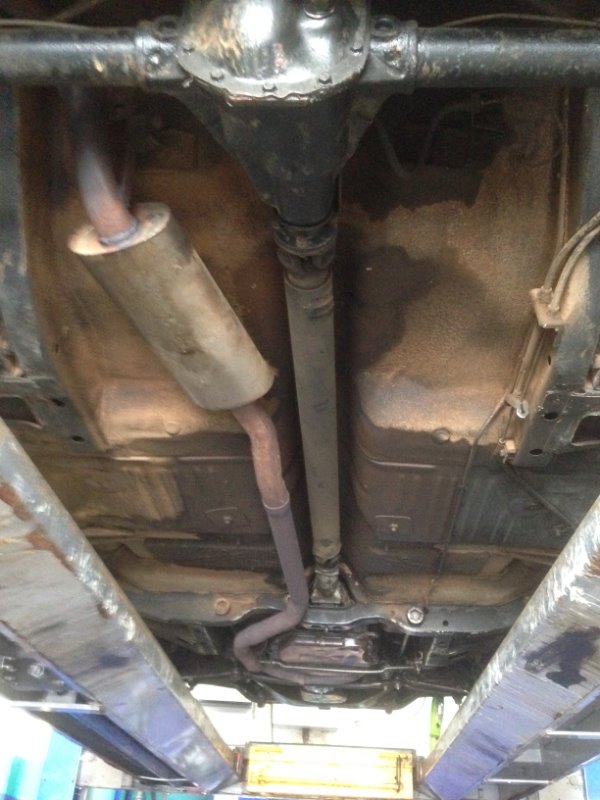

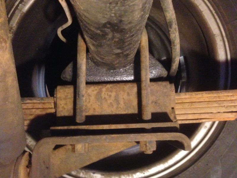

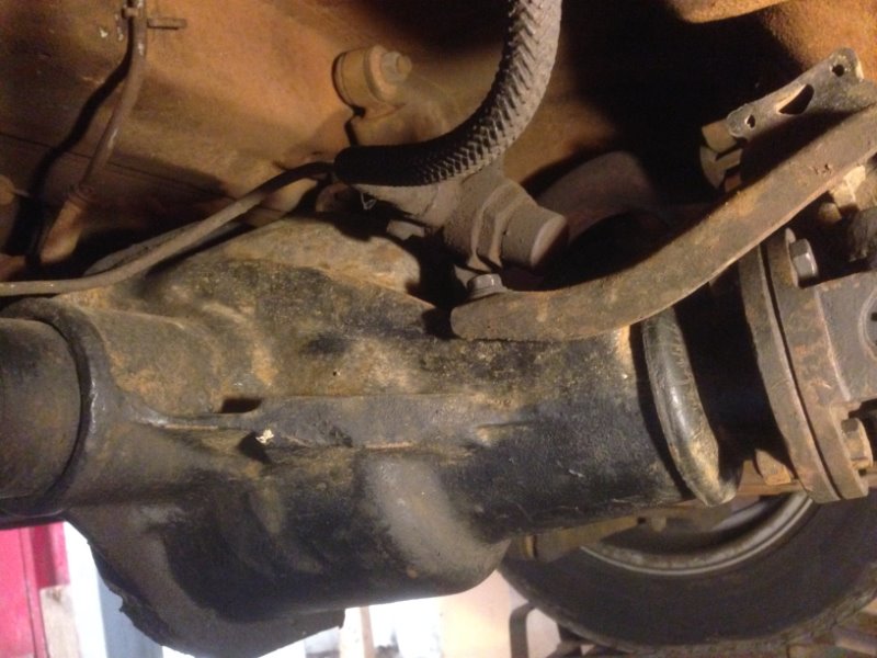

I've attached some photos, hopefully you can identify the axle. I would normally tackle a rebuild job like this myself but because of my uncertainty of ordering the wrong parts and I don't have an axle case spreader I'd rather leave the job of rebuilding a rear axle to a professional who can order all the correct parts.
The engine is a Chrysler 383 big block. Originally I think the car had a straight six engine in it, so if the rear axle is original it maybe under rated for the current big block engine.

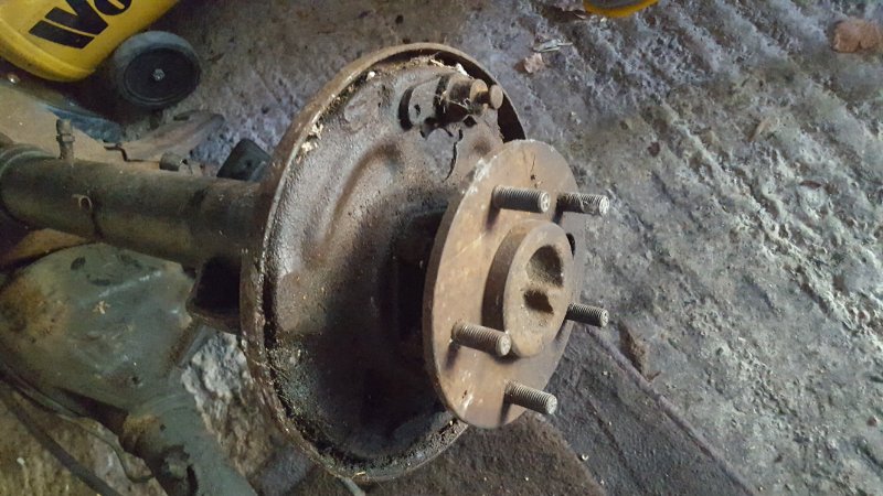

Re: Mopar 7.25 rear axle rebuild
well all but mid 60s aussie cars had a splined pinion and yoke rather than that flanged arrangement
it looks like a borgwarner in many respects, however the lack of borgwarner logos, the weld plug holes (big) for the axle tubes and the rear cover with the drain plug certainly point to it being a mopar 7 1/4
I have an Aussie M78 bare axle
what you get is a 2.92:1 open diff to the brake back plates and the yoke on the pinion. its a small dodge size, used internal circlip thingys like 318 dodge trucks up into the 90s. no yoke straps, 1 thing i don't have spares of, however you may find the flange you have fits BUT swapping may well screw up the preload on the pinion bearings
its a nice red rusty colour so needs a clean up
i can take the back off and have a look...post up photos etc
it has not turned a wheel in 15+ years so i can't say if the axle seals are going to be ok
you would need to add
vent
brake pipes
full aussie brakes...
and you might need to do something with the prop shaft to convert from the flanged one you have
i reckon its worth £80 not becasue i know of anything wrong with it more to do with the fact that you are the only interested customer in 10 years
Now they used these behind 360s but not 383s
they have the same saddle to saddle centre distance as a mid 60s B body as near as damn it 44" pre 71 valaints were 43 1/4 your will be 44 3/8
there is part of me that says get a mopar 8 1/4 in there or indeed a 8 3/4 and never have to worry again. the issue will be finding one at reasonable cost and you'd still have to get a prop that fits
both of those will cost more than £80 + the 200 or so you will need to spend on brakes i'd guess

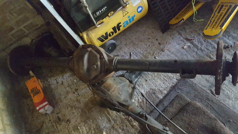

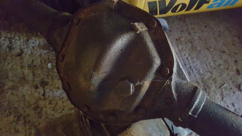

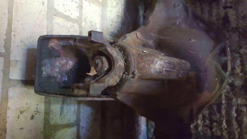

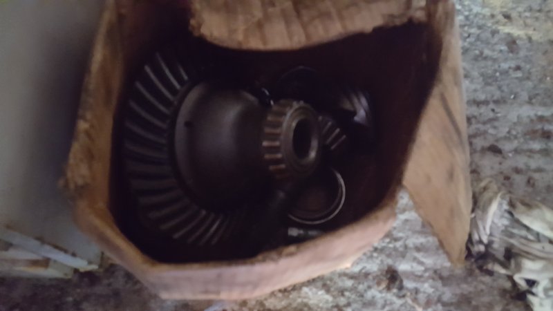

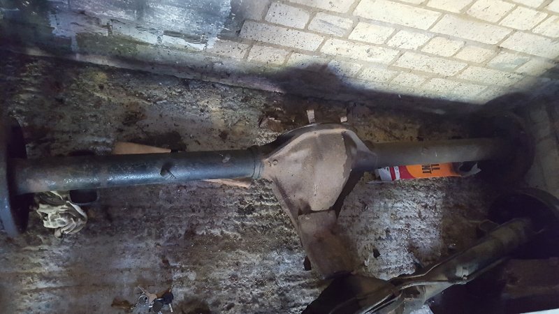

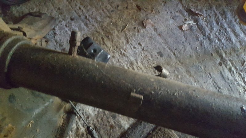

axle pics
apologies
if 2 axles in pic its the one on the top. the other is out of my car
apologies

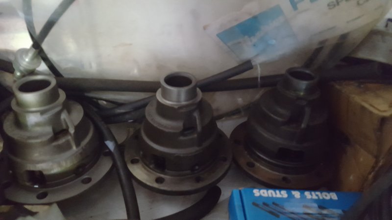

also available
i have a sure grip centre in 28 spline. would need 25 spline gears and cones added
open centre with good 2.92:1 gears
a set of 3.23:1 gears 7.5 inch not 7.8 will fit
a set of 3.89:1 gears in 7.5 inch not 7.8 will fit
the gears are more suited to a VF or VG diff they had M75 sized gears but they fit an M78 housing the morgan aero 8 uses this configuration
spare axle shafts
spare axle shafts
- 20180505_152201.jpg (39.12 KiB) Viewed 1720 times
- 20180505_152548.jpg (113.36 KiB) Viewed 1720 times
- 20180505_151946.jpg (38.48 KiB) Viewed 1720 times
