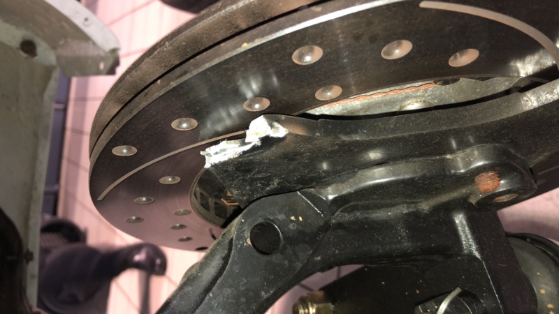

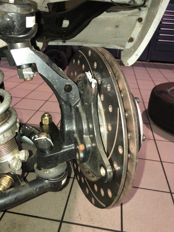

So driving to work today to give the dart a bit of a run and it was quite happy sitting at 70mph on the M25 when all of a sudden I get a noise from the o/s/f about 1/2 mile from the exit.
Fortunately for me the slip road was uphill as I had a brake failure, looks like either a caliper bolt has worked it's way loose putting pressure on the other one causing the adapter plate to snap, or the adapter plate has snapped causing the other bolt to fly off somewhere.
Either way not a fun experience but it could have been a lot worse, so I'm feeling slightly fortunate although somewhat poorer now I've ordered the replacement parts!

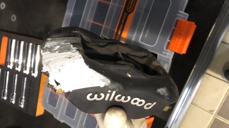

Couple of thoughts, did you shim the caliper so it sits central on the disc? How close did the calliper sit to the rim?

Hi Blue, yes was shimmed and looked to be central when we fitted it. Calliper was snug in the wheel but there was enough clearance and free play from what I recall

Wilwood specify minimum caliper to wheel clearances in their documentation. Worth checking.

I would have a very close look at the calliper clearance on the rim, rotatating it to see that there isn't a high spot of weld or something. I would check with Wilwood and get thier minimum clearance advice and then use plasticine on the calliper for a proper check.

Sounds like a good idea, strong possibility that if the calliper was catching the inside of the rim it could have become dislodged.
The only odd thing is that I’ve dont some mileage since all the suspension kit was fitted, so I figured if it was catching it would have happened sooner? Or I would have heard something?

If it had been very close and then picked up some road debris it would have put a crimp in your day..

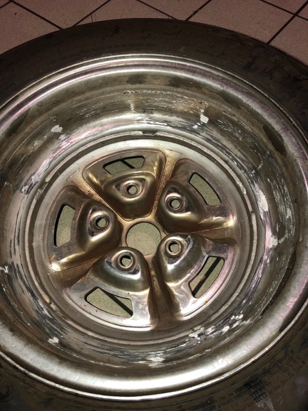

Just a thought but was there any balance weights on the inner rim of the wheel?
If there was and they were the stick on type, they may have come off and caused the problem

Funny you should say that, when I took off the other wheel to check it over the stick on weights were sitting in the top of the calliper.
I’ll rebalance the wheels when it’s all done and use the old fashioned hammered on ones on the rim.
