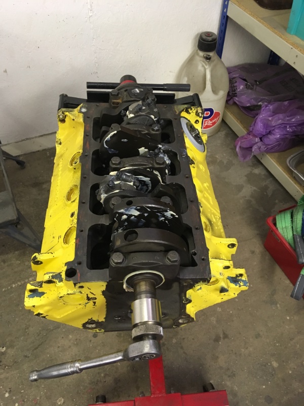

You know when you've just fitted piston no 7 and you're thinking one more to do and thats that, as you tighten up the rod bolt your torque wrench isn't clicking and you've already got double the amount of thread showing than all the rest? Yea that. New ARP bolts should be here by Tuesday when I can take all the pistons out and start again. Best get on with something else then....

Blue wrote: Thu Jun 28, 18 6:02 pm You know when you've just fitted piston no 7 and you're thinking one more to do and thats that, as you tighten up the rod bolt your torque wrench isn't clicking and you've already got double the amount of thread showing than all the rest? Yea that. New ARP bolts should be here by Tuesday when I can take all the pistons out and start again. Best get on with something else then....

had the same on a Jaguar engine with new ARP bolts when torqued. they stretched by 2mm at least. (the old bolts would torque fine)
when we told ARP they stopped production looked into it. Rang back and said use the stretch method only.
another set of new Bolts and have never torqued them ever since (about 10 years ago). for a Jag they should stretch 5.5 thou and it got to the point I did so many that I could get the stretch spot on first time just using a long spanner.
if you read the ARP directions with new bolts they should always be measured and noted before fitting, as when they are undone at a later date they should go back to the same length. if not don't reuse them.
Posts: 14502
Re: Blue's Barracuda
Never had a problem with ARP, Mopar performance are the worst rod bolts I have ever used, appalling quality.

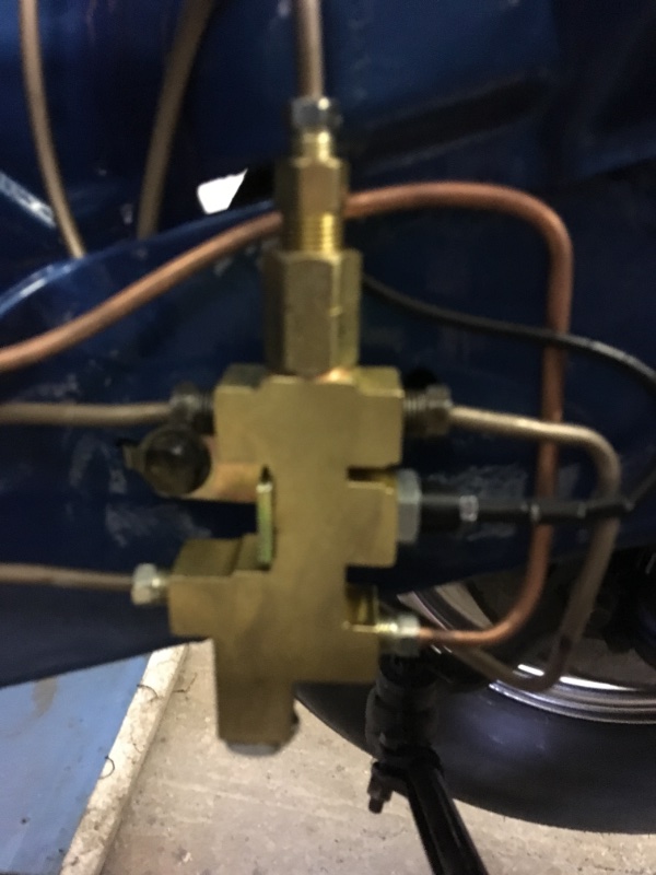

This crap repro part has been fighting me for the last couple of weeks with various leaks, thought I had it beaten but when it's under pressure it leaks between the main body and the large screw in adaptor at the top. The sealing surface for the copper washer is barely 1mm wide on both parts and nothing I have tried will seal it, it's just a really poor design. I have ordered another that doesn't have that part so hopefully I'll have more luck with that.

You hear this all too often Blue, so much cheapo crap around, and not all that cheap either
